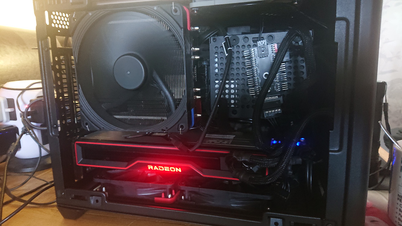

Hi had the NR200p since it came out and thought I would post my current build before watercooling.
I have 3 fans (2 below the gpu, 1 at the top) connected to the gpu pwm via a splitter and into the fan hub so they do not spin unless the gpu is in use which I really like as the system is silent under light load, those fans have a noctua low noice adapter on them as well so when the gpu is used they are nice and quite.
Full specs
Ryzen 7 3700x on a MSI 450 itx gaming cooled by a noctua C14s with a cromax a14 fan
32 GB DDR 4 3600
RX 6800 reference
EVGA 650w g2 sff psu
500gb samsung 970 a 2 x 1tb ssds.
2 x Noctua NF-F12 PWM chromax below the GPU ,1x Noctua NF-P12s redux and 1x Noctua NF-A12x15 PWM at the top of the case.
I did have a Powercolor Red Devil rx5700xt with a deshroud mod with the 2 noctua NF-F12 and that worked really well, if anyone has a 2.5/3 slot card I can recommend.
