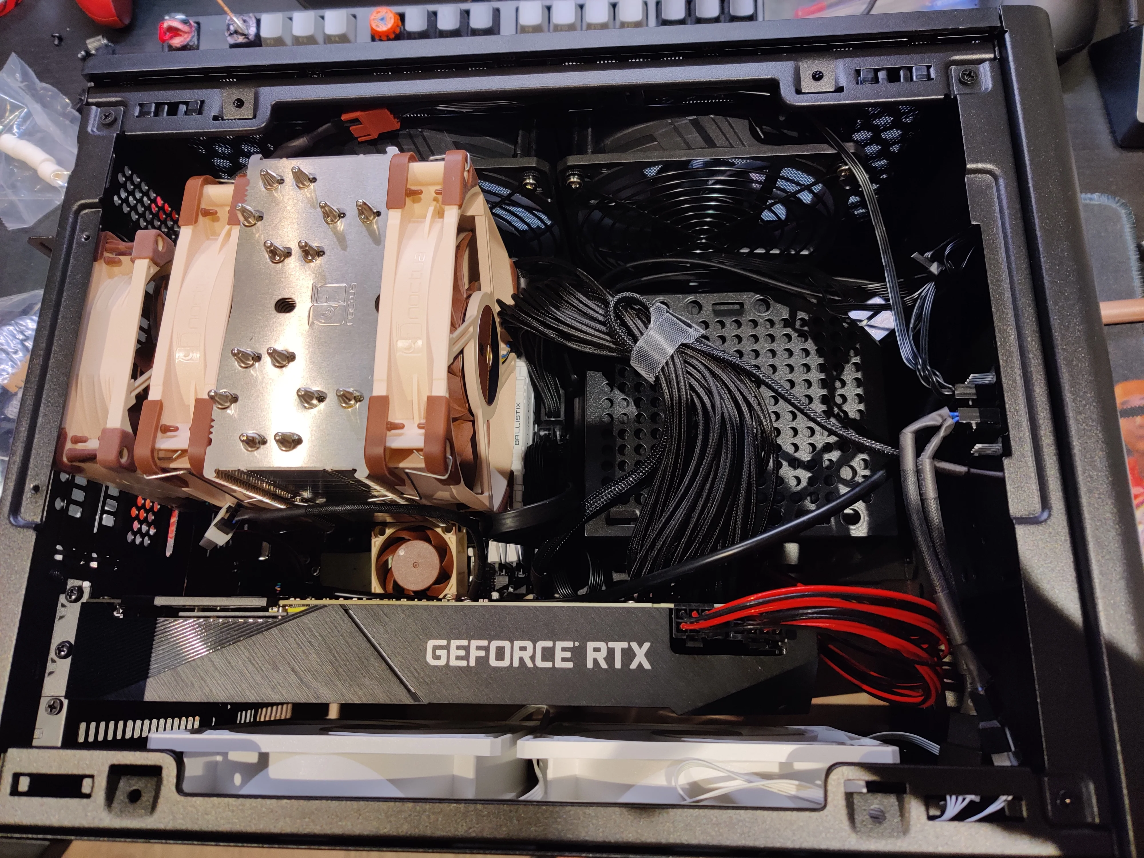

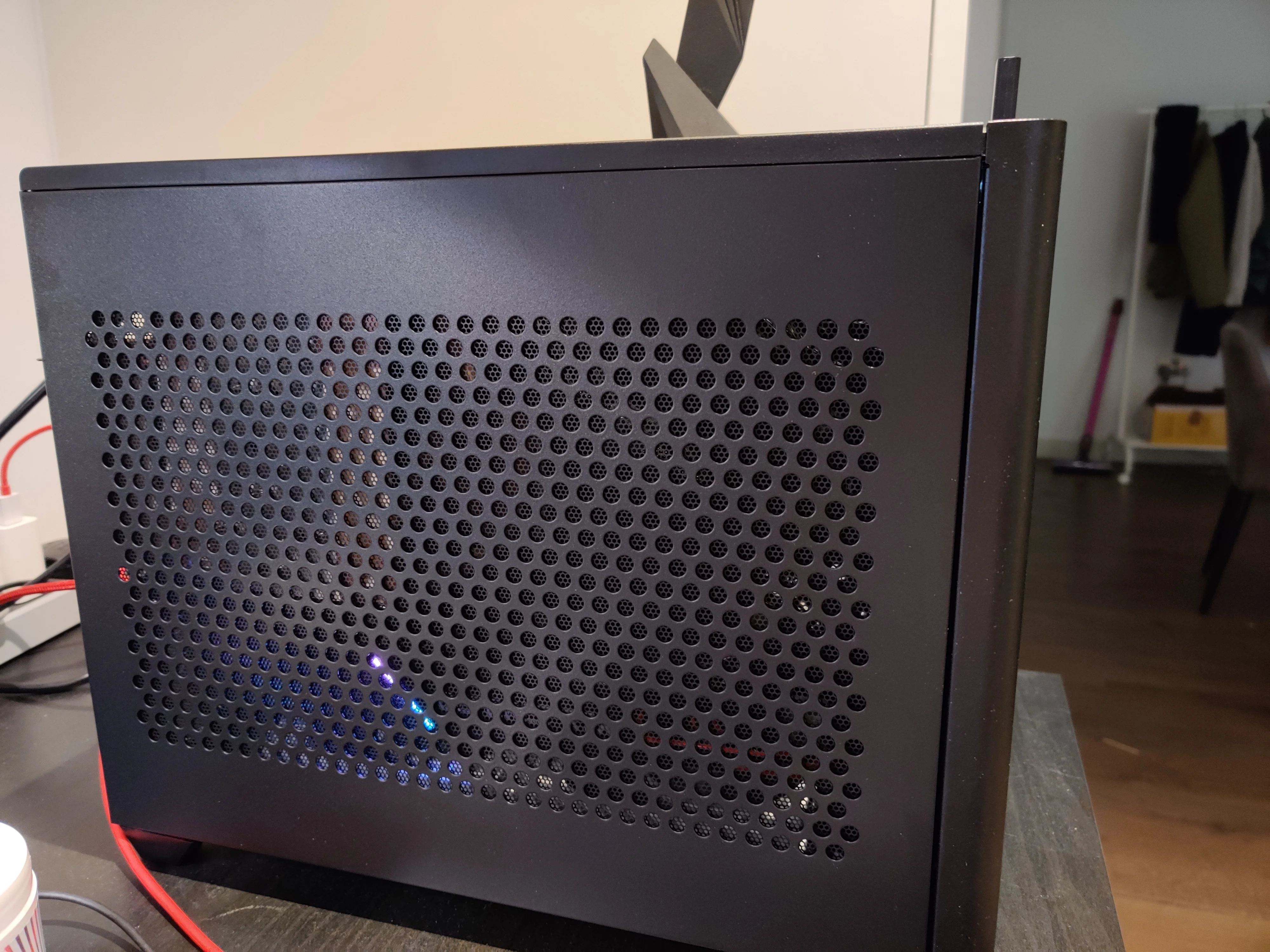

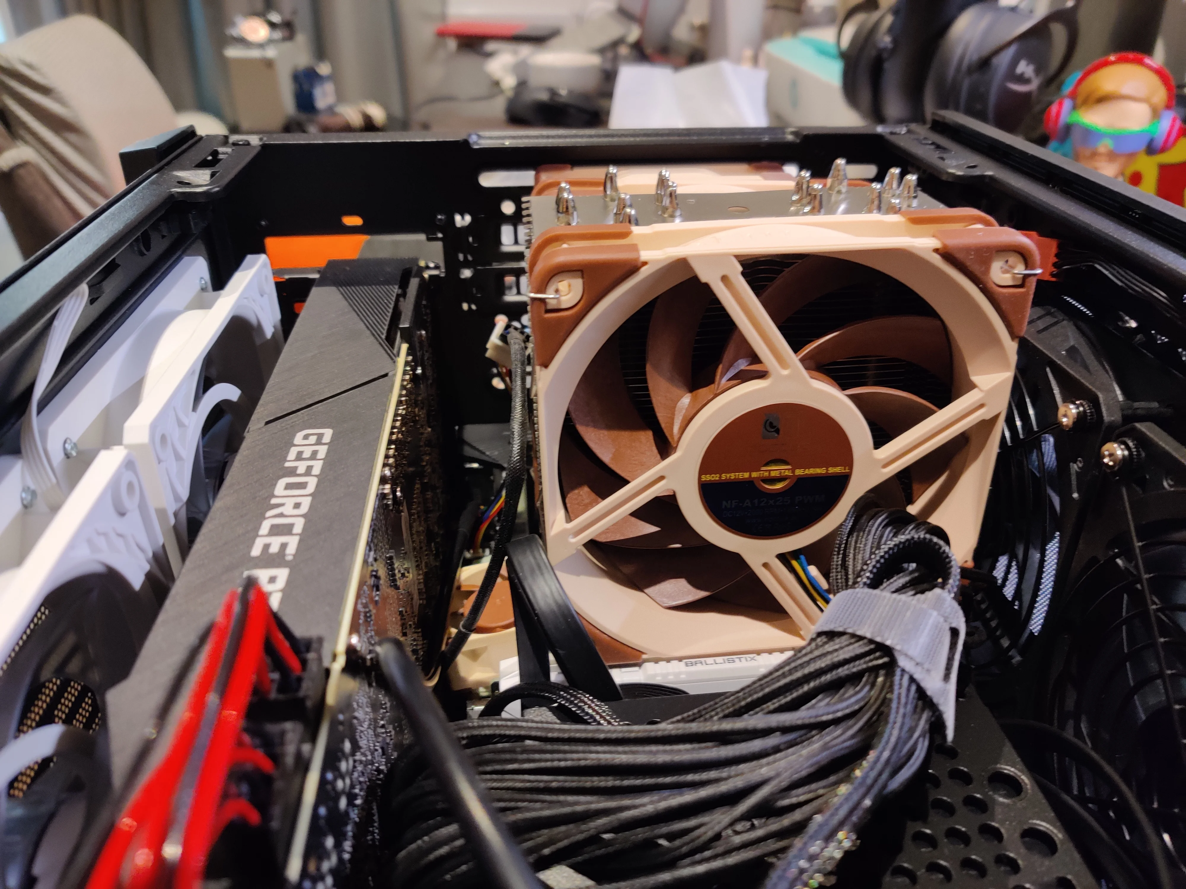

NH U12a arrived today. So here is the final build. The u12a fits just fine with the vented panel. Thermals looking great with two bottom fans intake, rear and cooler intake and top exhaust. 3700x hits all core 4.1Ghz in Cinebench R20. Totally satisfied with it.
That looks great, amazing fit on that cooler, wonder why they don't mention it in the spec, makes the case so much more versatile with CPU cooling.
