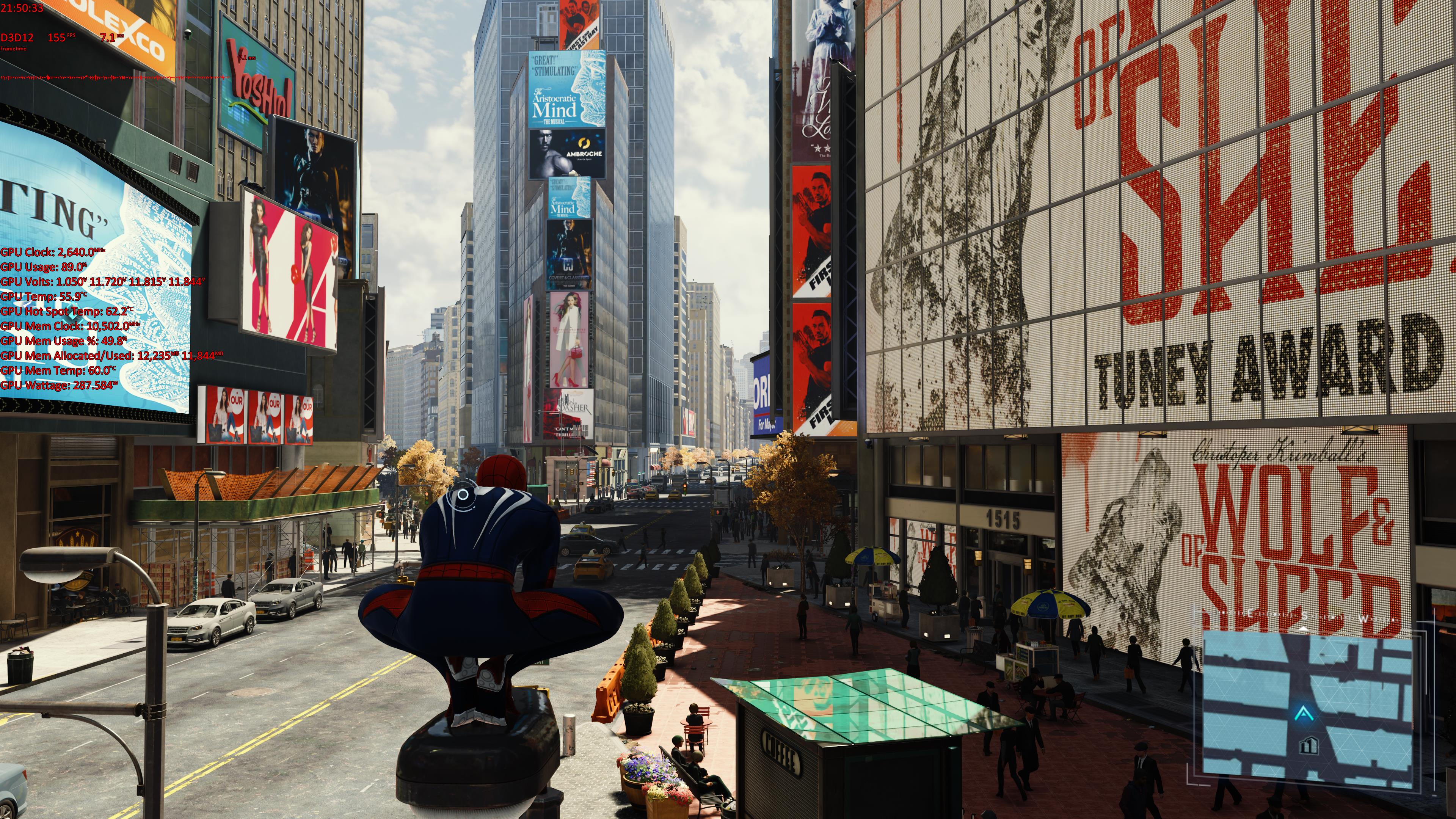

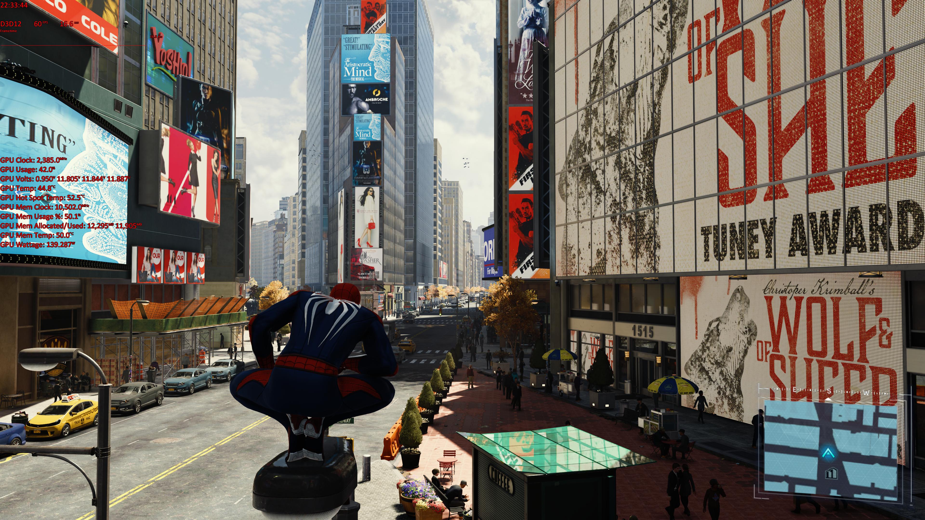

It varies from game to game but this is the result in Spiderman Remastered, Max settings, DLSS Quality, FG etc...
Stats on the left hand side, Wattage at the bottom of the stats.
Stock
Power level set to 70
Power level set to 70 + undervolt.
Stock
200w with the PL and undervolt is nuts but you do take quite a hit in performance though. Nice to see it can be achieved, i might try this setting on a game that runs stupid fps by lowering it to 200w. Would certainly save me a lot of unncessary heat generation.
I tried various settings and found that to be the best overall one for perf/power usage.
Same i've been playing about with it for 2 days now but your settings seem to be the sweet spot. Learning how to undervolt this doesn't seem that different to how i did it on my 3090 come to think of it now.
And in this specific game if you turn off frame generation and limit the FPS to 60 as 60 is perfectly playable, The power savings go down even further which in turn drops the heat output.
