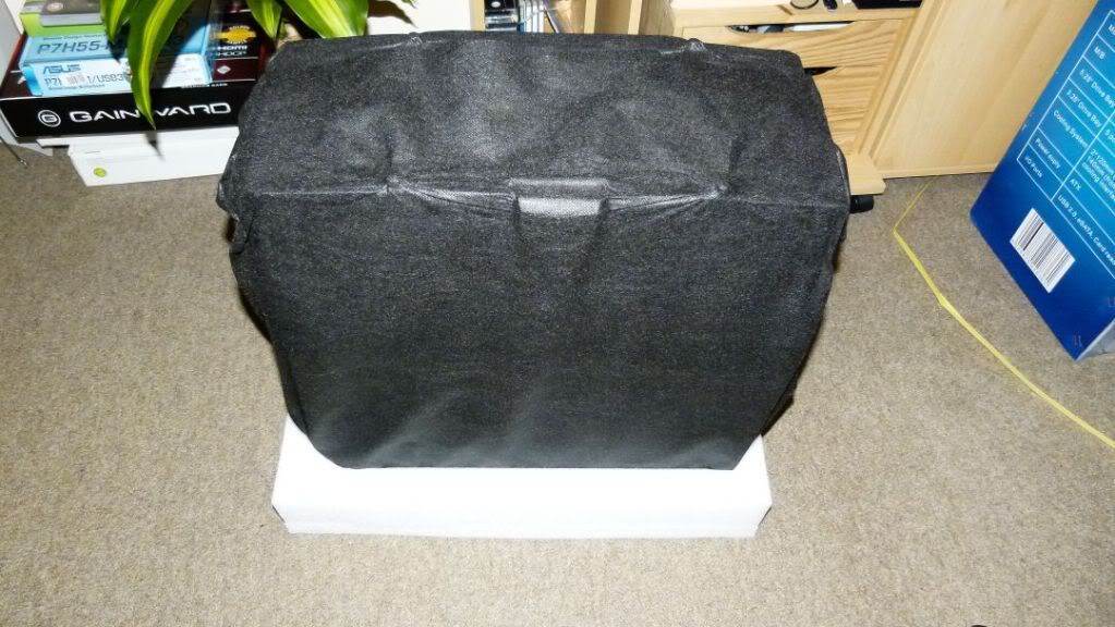

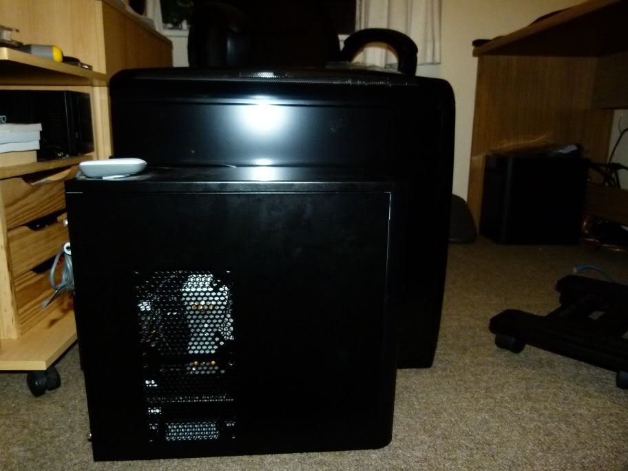

After seeing the box upon returning home, I hoped that there would be a hell of a lot of padding and packaging, and that the case would be substantially smaller.
Unfortunately not (not to say it's badly packaged), and the case is absolutely massive! Comes with a nice cloth cover too

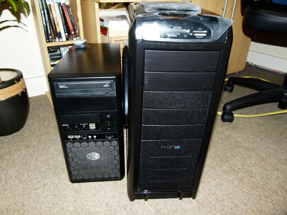

It's certainly the largest midi tower I have ever owned in my life.
It absolutely dwarfs my old matx cooler master case - I still miss the smaller size a bit, even after a week.

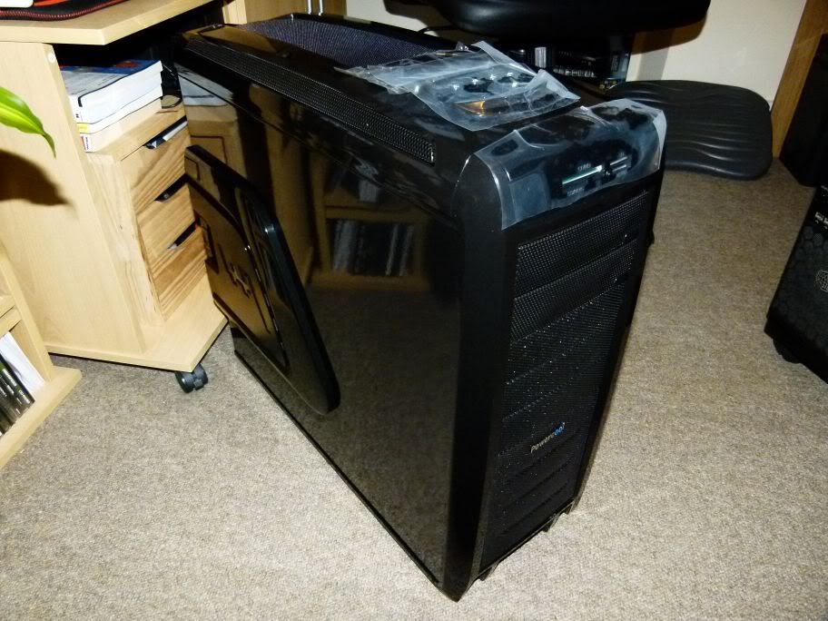

So first impressions would be, the build quality is not bad, but nothing special. Its solid enough all round, but there is a lot of plastic, and some of that can be flimsy, especially the underside of the case.

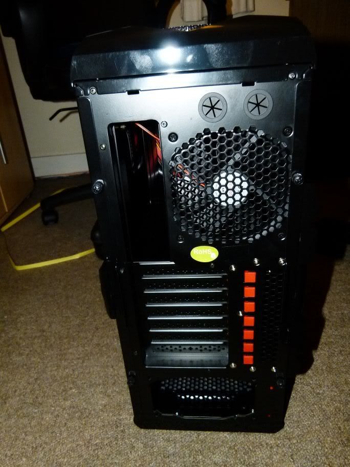

The back - nothing special.

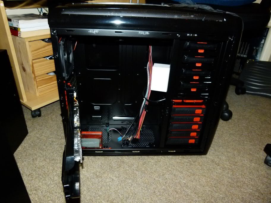

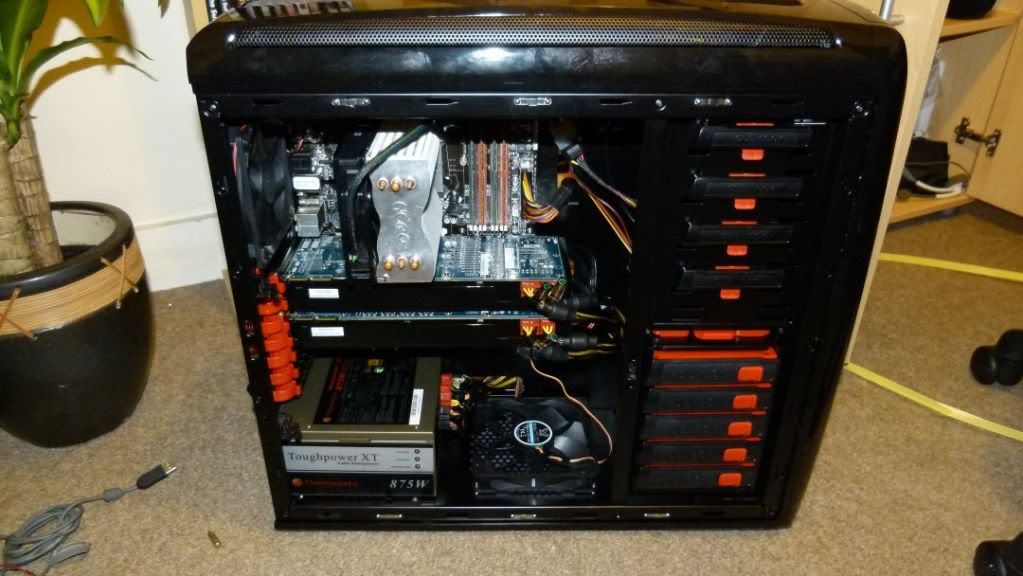

Opened up. There is loads and loads and loads of space in here.
From when I looked at pictures before buying, the pictures made it look smaller than it really is.

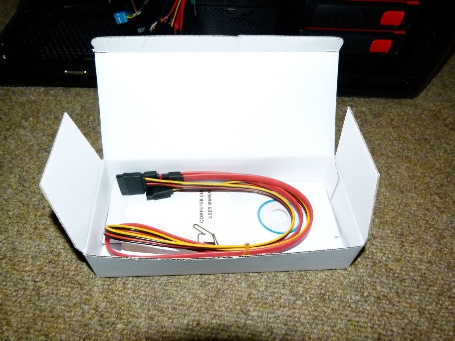

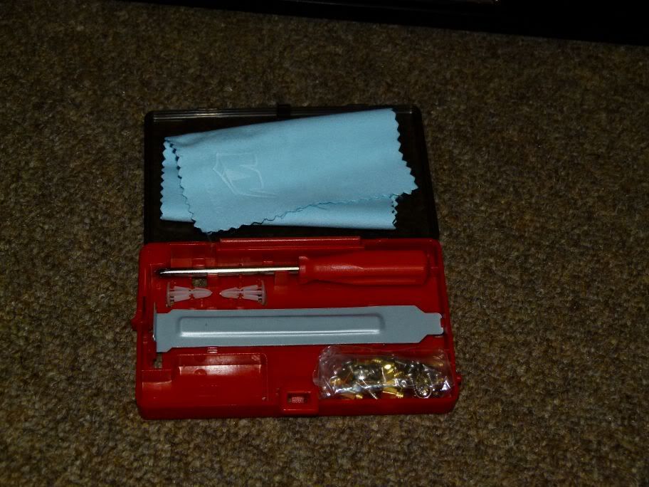

Accessories come in the form of spare SATA power and data connectors (for using to connect to the top panel external connector) and a little "toolbox", which contains a little screw driver, backing plate, screws and a very handy cloth for wiper this finger print magnet down

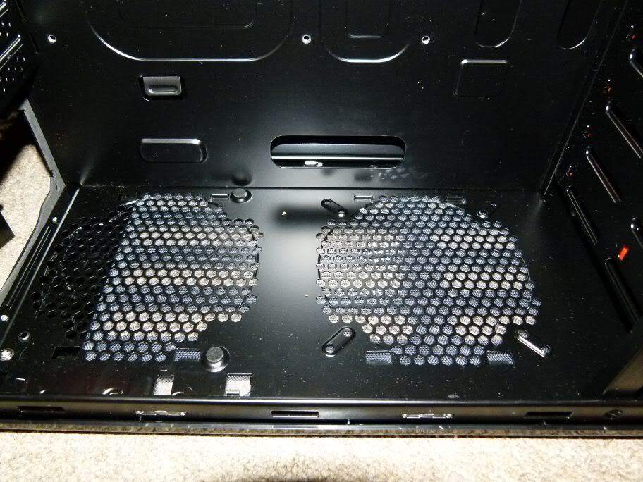

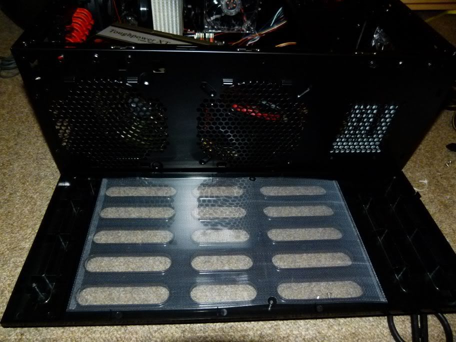

Here you can see the bottom has grills for power supply and another 120/140mm fan. TIP - If you want to put a fan here, do this first. The base comes off, as pictured below, but one of the screws is located under the PSU!

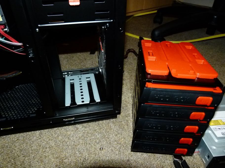

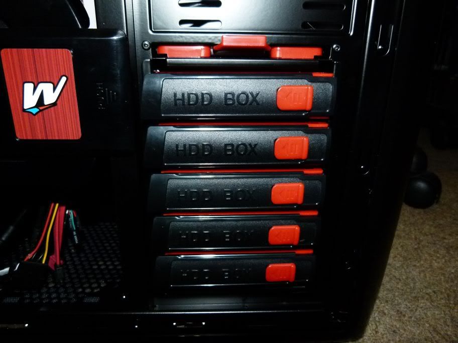

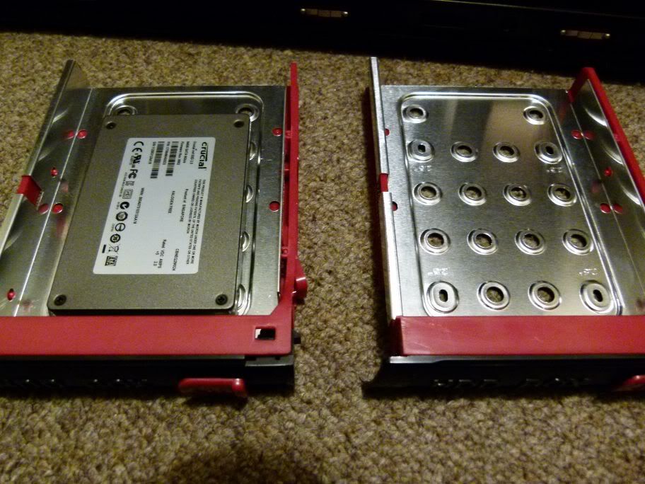

Hard drive cage is a bit flimsy, but doesn't rattle, so all's good I guess. It can be completely removed should you so wish. The trays include holes for screwing in a 2.5" drive - however, as they sit forward in the tray, connecting the power and data cables can be a pain.

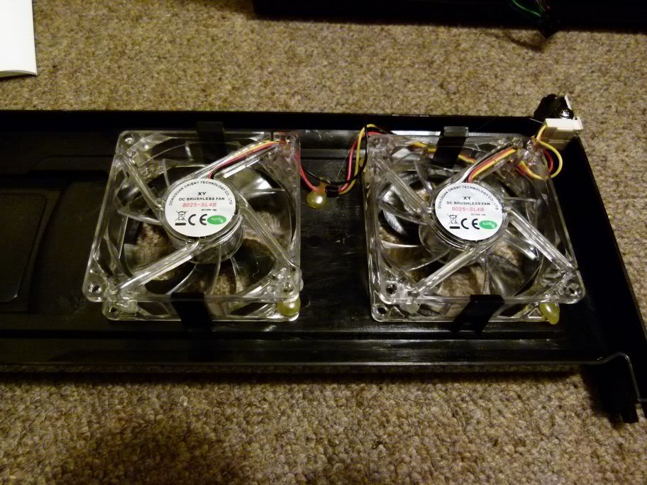

One reason I got this is because I thought the dual 80mm fan mounting across the gpu's would help keep my crossfired 6950 toxics a bit cooler.
Do they help? Yes, I think they do, but there is only so much you can do for the top card when they are sandwiched together like they are on my current matx case.

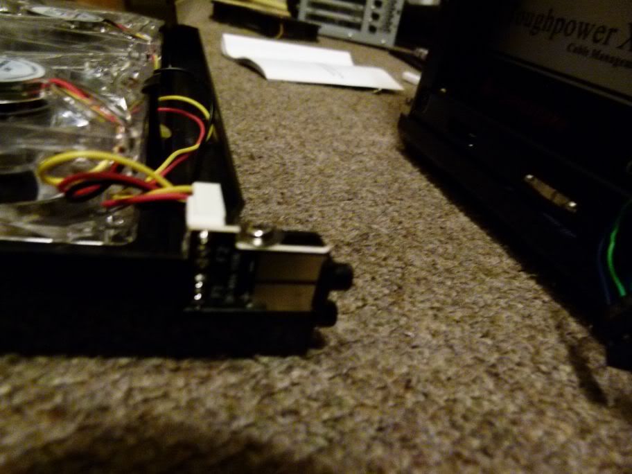

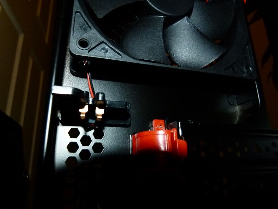

One problem though is the connectors for getting power to the things. After a week (ok, I have been taking things in and out of this case a lot over that week) one of the connectors (third pic down) has all but broken, and I have resorted to connecting the fans to my front fan controller.

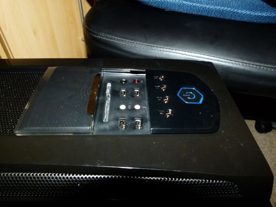

The top connector panel has a sliding cover. Mine stays open pretty much all the time though due to using my headphones a lot lately.

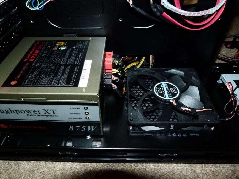

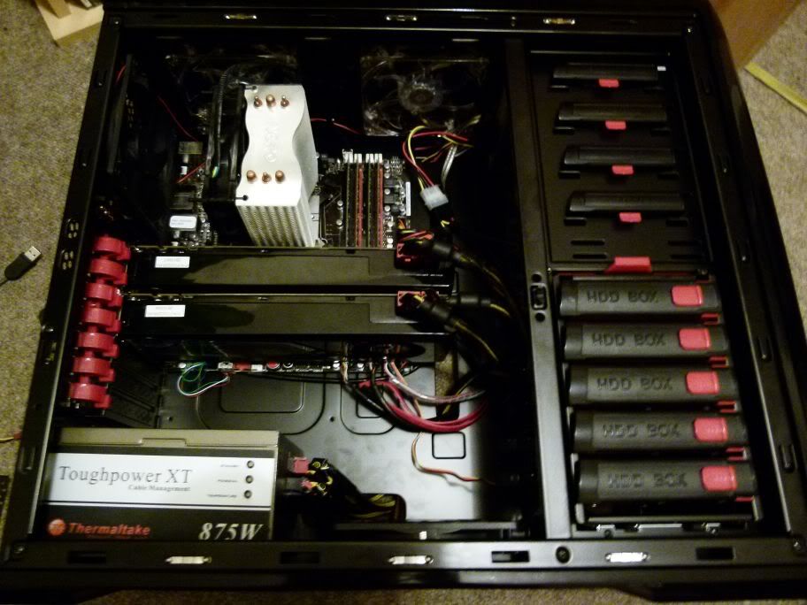

So getting things in, plenty of space down there for thermaltake toughpower 875 PSU. I imagine if you went for a really long psu, you may not be able to squeeze in a 140mm fan, though should still manage a 120 - unless the PSU really is huge. Either way, there will always be room for PSU.
And my current matx board looks diminutive in here.
One thing though, should you have either a full atx board you use the onboard for, or a sound card located near the bottom, you may fine the audio cable short. I was only just able to connect the front panel audio connector.
And with everything in, plenty of room still to spare. This should swallow any graphics card manufactured to date I think.

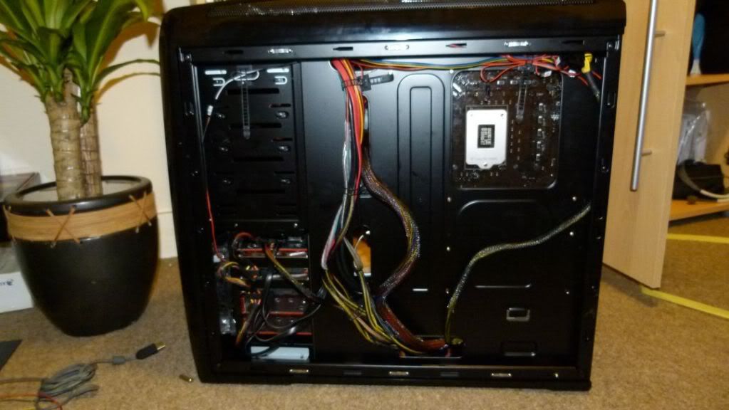

And things are kept fearly neat on the rear.

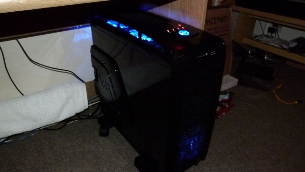

And finally, getting it up and running...
