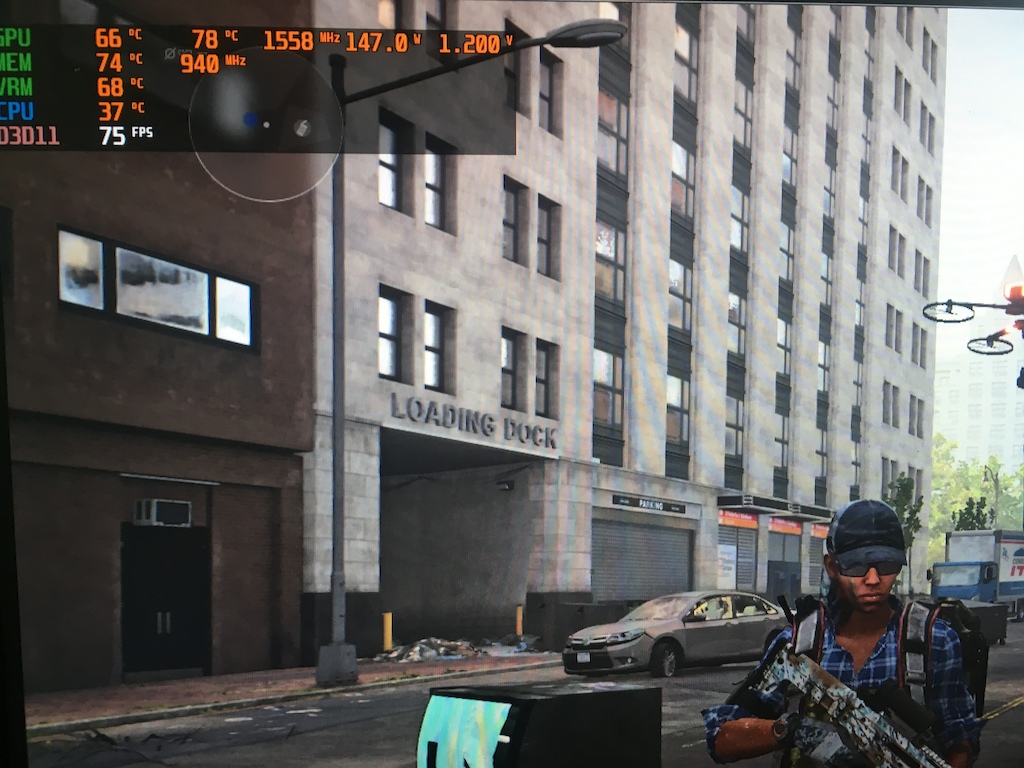

Noticed my rx 580 wasn't acting as it should in games. power usage was way down on normal and thus frequency and fps were stupidly low.

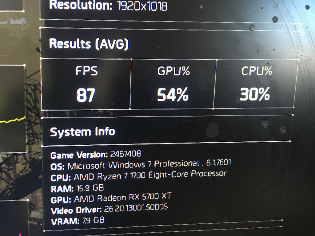

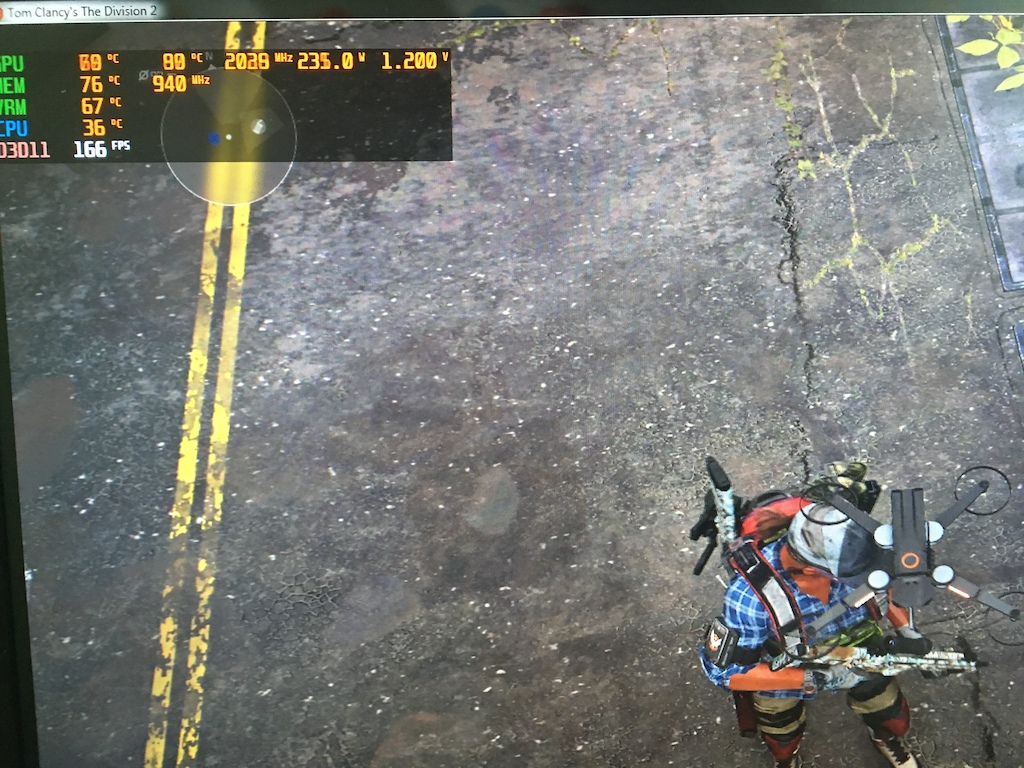

Recently bought a 5700 XT and the same thing is happening. Fine in firestrike and superposition but the division 2 its being really odd. Benchmark only gives 54% GPU usage while in game if I look at the ground it powers normally and has a high frequency but if I look up the power/frequency goes down.

I can only assume my ryzen 1700 is bottlenecking the 5700 XT even though the CPU isn't 100%. Tried the 580 on another computer that has the same mobo and graphics card to compare. needed an extra 20% power to hit stock clocks in firestrike but was fine running the benchmark of wildlands (two cards scored pretty much the same). Earlier graphics driver so will roll back mine at home and see what happens.
Download Shadow of the Tomb Raider trial demo on Steam and run that benchmark, I can tell you for sure based off of that if it's CPU bottleneck and not something else.
That was my original thinking but it is a fairly powerful cpu. Cant see a 580 being bottlenecked by a 1700 even at 1080p.
Depends on what the game is using I guess so best bet would be to run a game and monitor the cpu usage across each core rather than just general utilisation.
