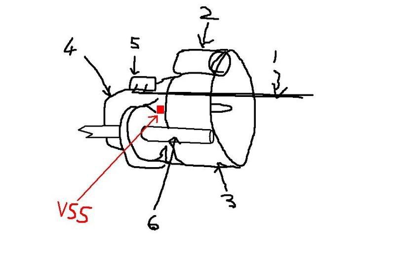

Here's the VSS:
1. Shift linkage
2. Starter Motor
3. Bellhousing
4. Gearbox
5. Gear Selector Mechanism
6. Offside Intermediate Driveshaft
Thanks to Jamie Duff from the Cougar forums :)
The VSS costs around £65.
