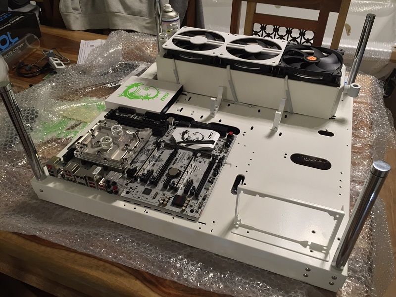

I found that the feet are simply not strong enough. Not enough support on the case and it flexes.
deffo wall mount it.

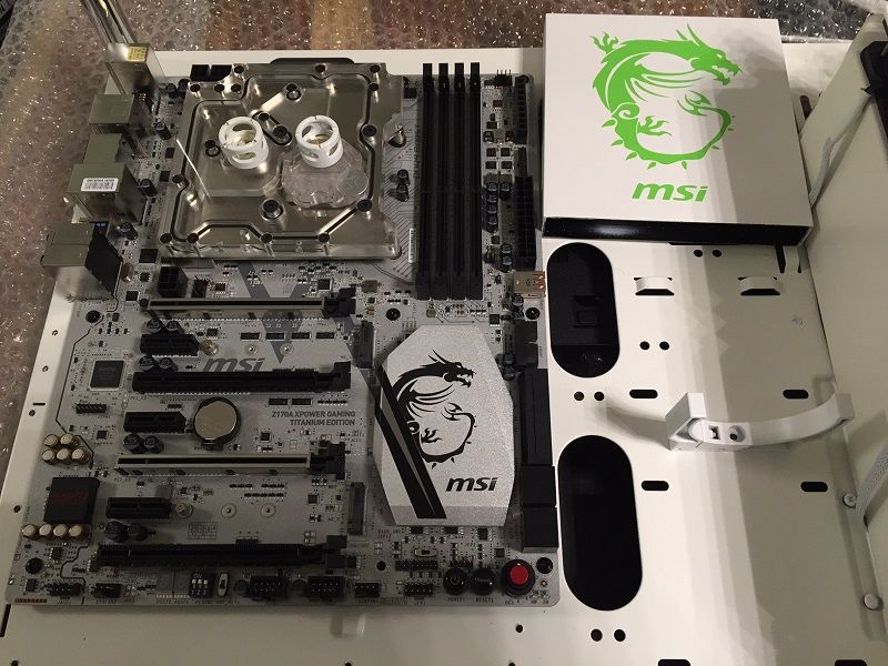

I plan on wall mounting mine. As you can see the case has been powder coated white. The square MSI logo'd case is actually a slot loading blue ray drive.
