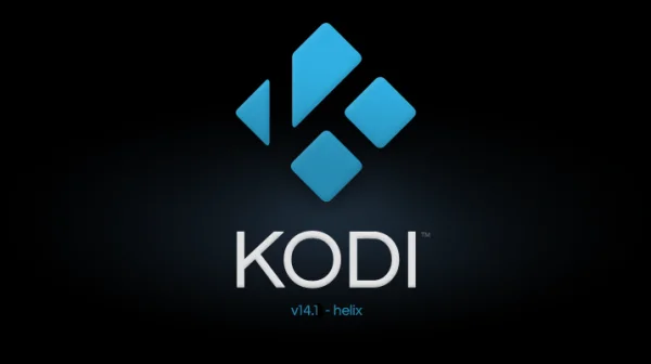

There's very little information here about Kodi (née XBMC), so I thought I'd start a thread, every other subject has an "*** Official ***" thread, so why not this?
Current Releases
Current Stable Release: v14.1 (Helix)
We are proud to announce the release of Kodi 14.1, which comes with a new name, a new logo, and a wide variety of new features, but underneath the new coat of paint remains the same software we all love. This is the first small bugfix release in the Helix range. As we have mention in our Kodi 14.0 release announcement, we will be releasing these to squash down any issues left after the first final release. Below you will find a list of fixes so far.
