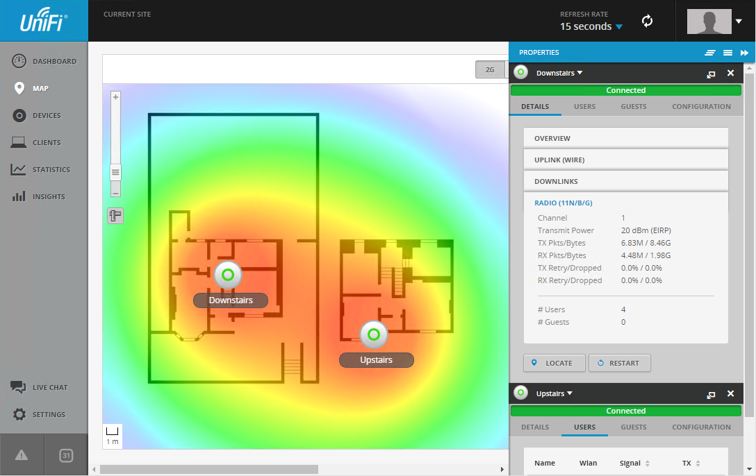

Not sure how I lived without these bad boys.
Just got the pair to replace my N66U that I was using purely as an access point.
Don't take this image as an exact replica of my coverage. The top and ground floor obviously aren't placed side by side like that.

My testing, without zero handoff - using facetime I am able to walk from the ground floor to the top floor and watch my iPhone move between the two access points. Once upstairs I'm able to physically disconnect the upstairs AP and watch my iPhone flick back over to the weaker signal downstairs. I can even reconnect and I'll jump back to the better signal AP. All this without loosing connection BUT I do get a little choppy video / audio when I make the transitions.

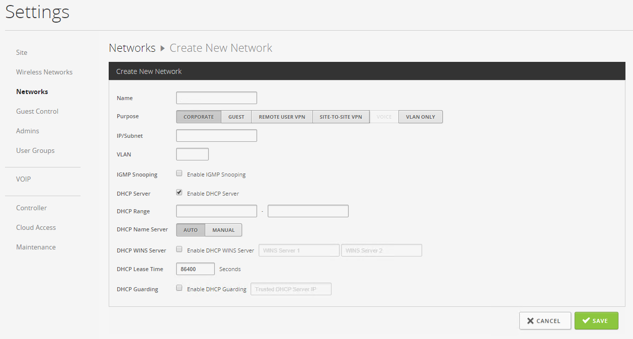

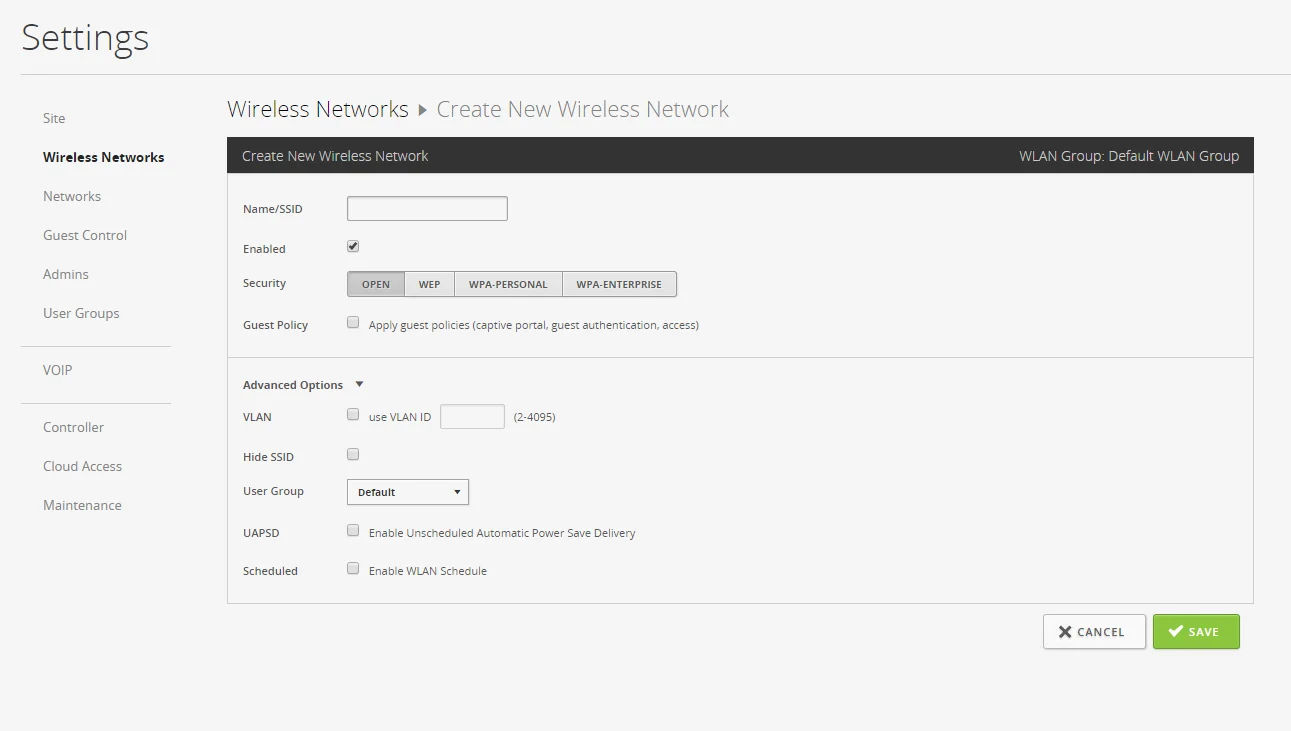

Ok, from my understanding (I'm not an networks specialist and only had the devices for 48 hours!) you wouldn't be able to set up OpenDNS servers for just the "Child WiFi" by JUST configuring the AP's
The most you could do is create a separate SSID and set that SSID to use a different "network" (which I understand to be creating a new VLAN really) and assign that to the child WiFi SSID.
When you create a new VLAN these are the options you get:
When you create an SSID these are the options you get (note the option to choose which VLAN it uses)

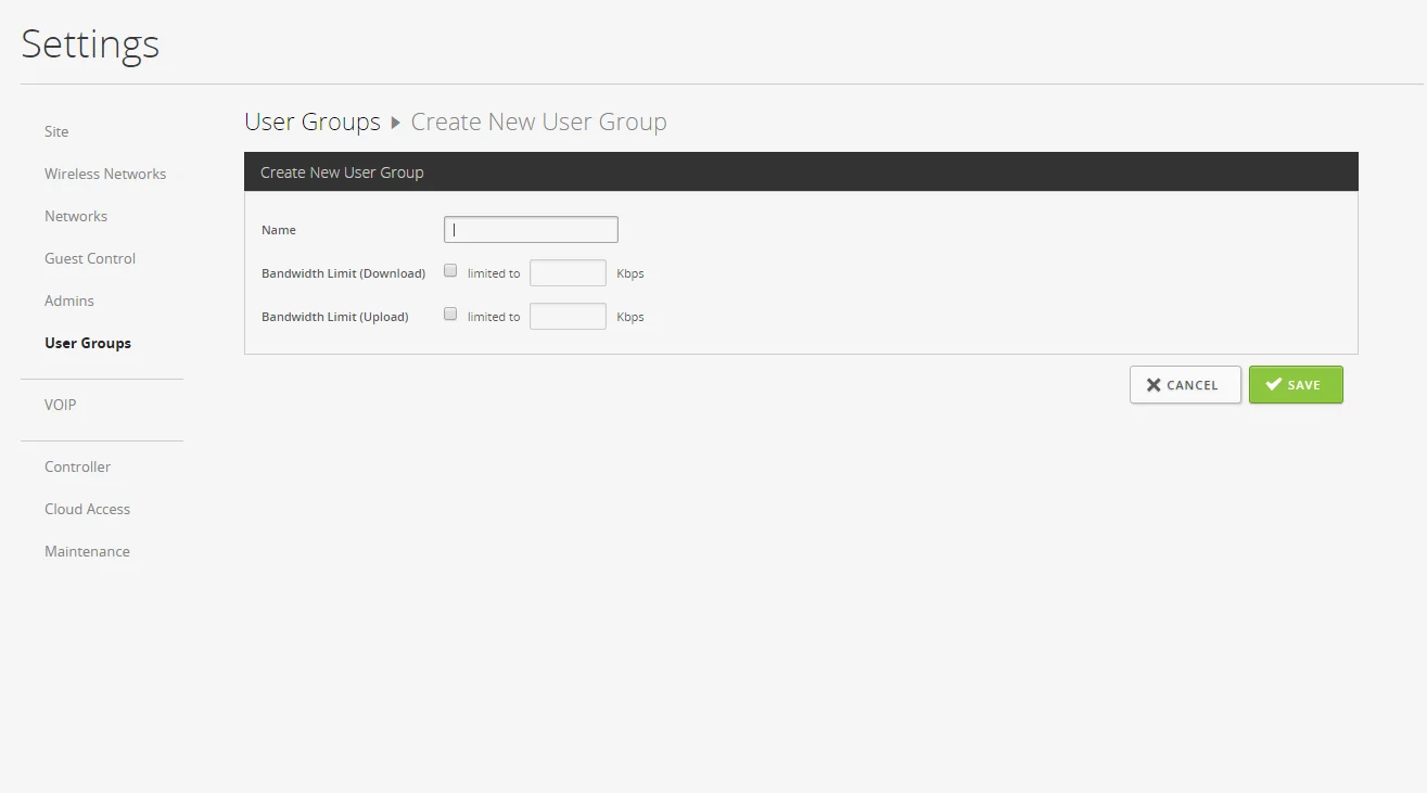

Annoyingly "user group"s are quite limited as well - I thought you might be able to change a little more in there.

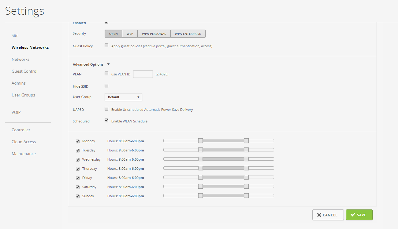

If you want to schedule use of the "Child WiFi" that can be quite granular though, which is nice!
Below is settings on a per SSID basis. When scheduled to be "off" the SSID is disabled completely. So there's no getting around it.
