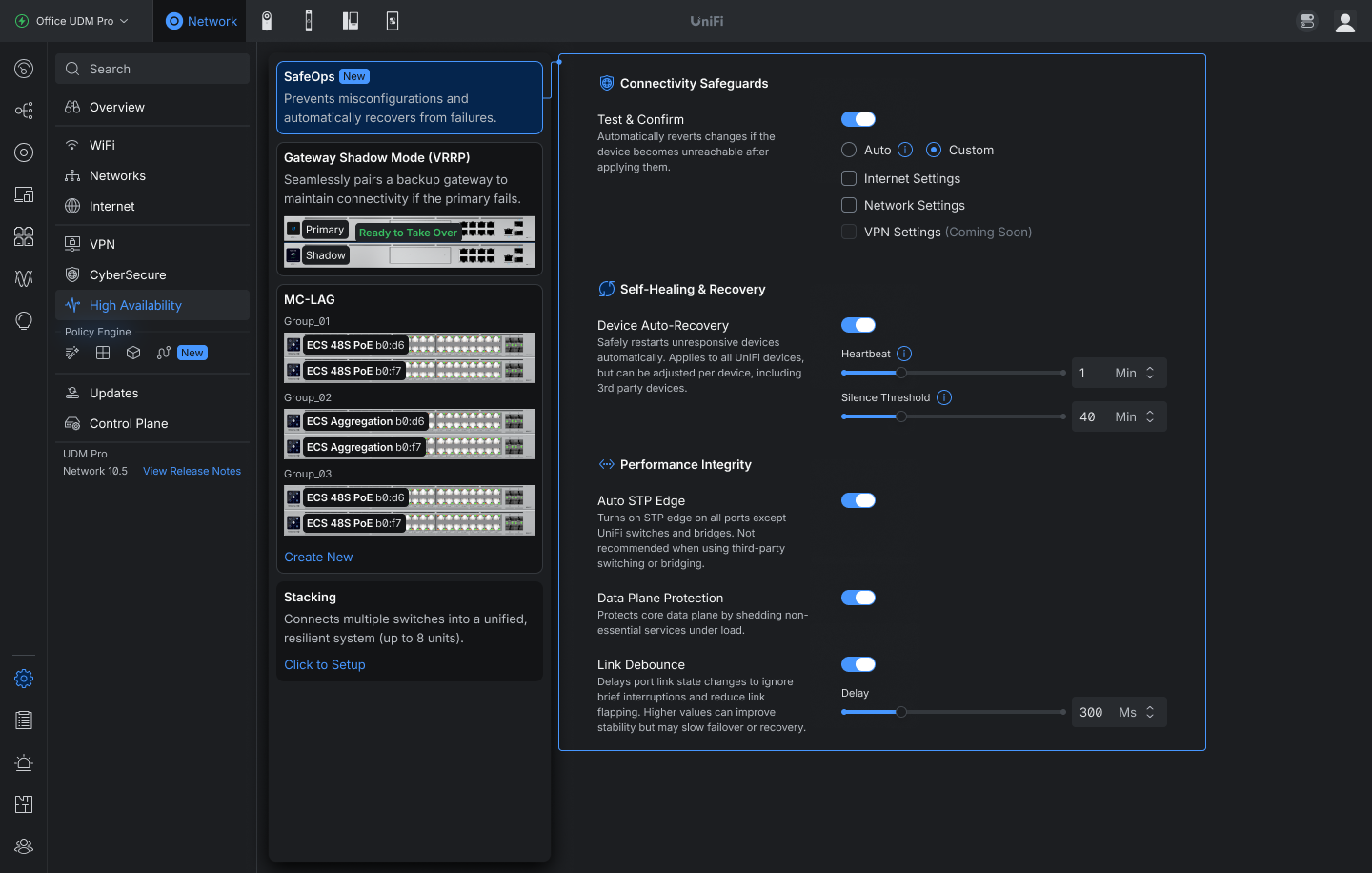

Overview​
Client Observability
Gain complete visibility into client behavior with a 24-hour activity timeline that correlates connectivity, roaming, application usage, and network health into a single troubleshooting experience.
  • Review a 24-hour time machine of client activity and events.
  • Track connection quality with signal strength, TX retries, latency, and packet loss.
  • Analyze roaming history and access-point performance affecting the client experience.
092b2443-8ec7-4e1c-b5bf-c92eab77d3eb
Safe Ops
Safe Ops introduces proactive protection and recovery mechanisms designed to reduce outages, maintain connectivity, and improve operational resilience across UniFi deployments.
  • Added Auto STP Edge that automatically sets ports connected to end devices as Edge.
  • Added Link Debounce controls to reduce link flapping caused by brief interruptions and unstable connections.
  • Requires USW 7.5.4 or newer.
  • Added Test & Confirm safeguards that automatically roll back changes if device connectivity is lost after configuration updates.
  • Available for Internet and Network settings. Wider support coming soon.
  • Requires UniFi OS 5.1.12 or newer
  • Added Data Plane Protection.
  • Enhanced Device Supervisor with global Auto-Recovery controls, including configurable health monitoring and recovery thresholds.
5012aa92-2799-4edb-a41a-c40372ba7a71

Oh wow they've finally copied commit confirm. If that's implemented uniformly across the stack it's a great feature.
The PPPoE baby jumbo thing is very funny if you're familiar with the quantity of forum posts with Ubiquiti employees asking "why do you want that" for about 15 years.
