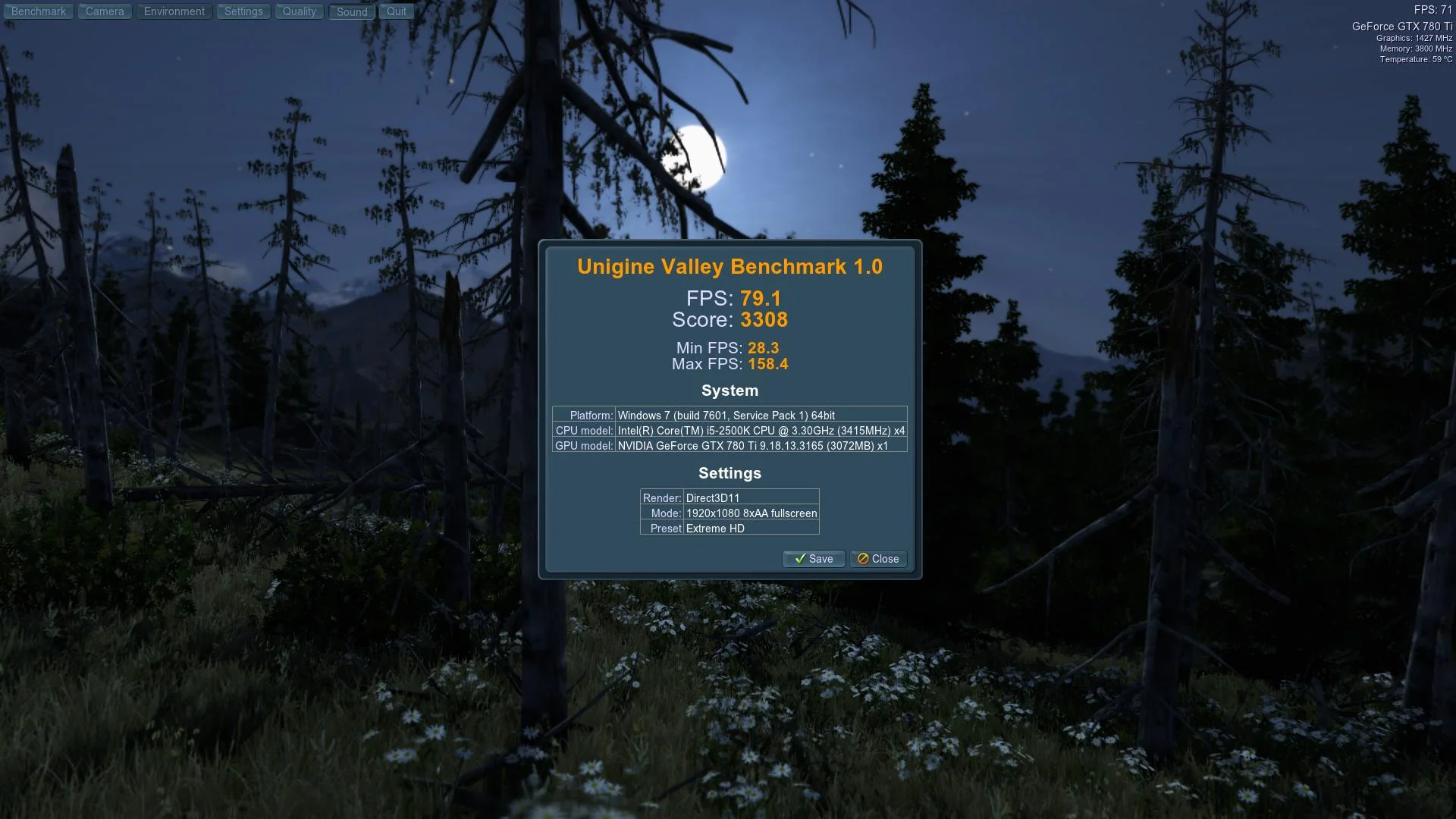

1080p score 3308, GPU GTX 780 Ti @ 1101/1900, CPU 2500k @ 4.55GHz

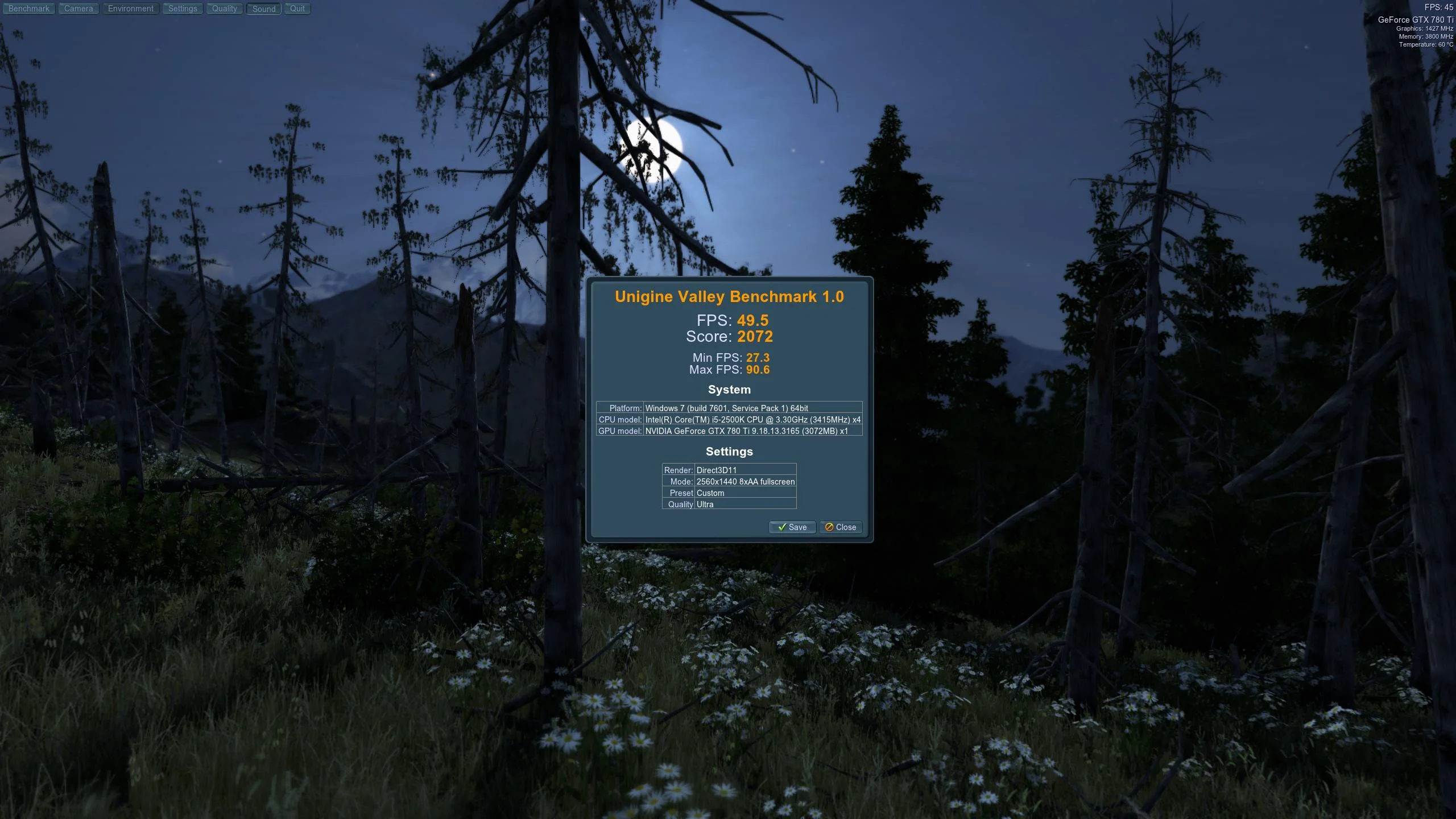

1440p score 2072, GPU GTX 780 Ti @ 1101/1900, CPU 2500k @ 4.55GHz
