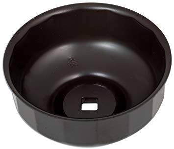

I just use a specific tool for the cars where possible. For the Fiesta MK7 it's something like this which just goes on a standard socket wrench. I own and use one of these for my MK7:
For the other cars I've owned/still own (S-Max/Mondeo/BMW E90 and F30) they use the cartridge filter with a plastic cap so I have a set of oil filter housing socket adapters like this:
Not sure what the S60 uses but it seems like one of those oil filter socket adapter sets would cover you from a very quick Google search.
Yeah that's what I'd recommend also. Allows you to put a rachet drive on. I don't think it's that much more expensive. I suppose the only downside could be its for certain models of filter so might not fit your next car.
