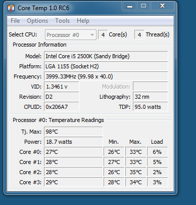

cpu z shows vid:1.3461 v , i dont think i changed vcore when i changed multi to x40 tdp:95w cpu idling at 26c now and power 14.4 watts
with that voltage ud probably hit 4.5g the problem is i suspect ur motherboard is set to auto voltage this will allow the mobo to put whatever voltage it thinks the cpu needs to be stable. usually this is much higher than needed. so if u change the multi to 44 ull probably be seeing high temps and a silly voltage pumped thrugh ur cpu
see if u can find a setting to set a fixed vcore and set it to 1.30 volts. then test and check what volts cpuz says ur running

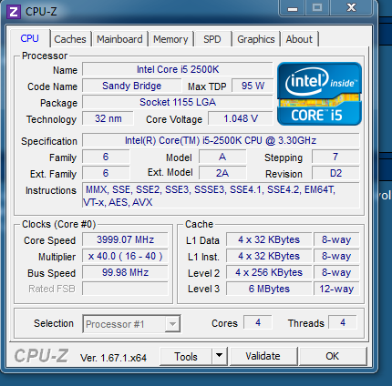

IN MY PREVIOUS POST ABOVE I SAID CPUZ SHOWED THE 1.3+ V BUT I USED CORE TEMP NOT CUPZ you still around pob just that i downloaded cpuz and that says the core voltage is 1.000 v but goes up to 1.048 v , the first voltage i got was from core temp,both programs show different voltages or am i wrong i dont know
i googled and read ""Core Temp is showing you the VID, not the actual voltage. CPU-Z is showing you the real voltage."" is this right/

if auto is ur only option give 44 multi a try and keep an eye on the voltage and temps. it shoudnt need more than 1.3 v for 4.4 but as long as temps are ok (70 or under) try not to let the volts go over 1.38. and yes use cpuz for the core voltage the vid is a different thing altogether.
