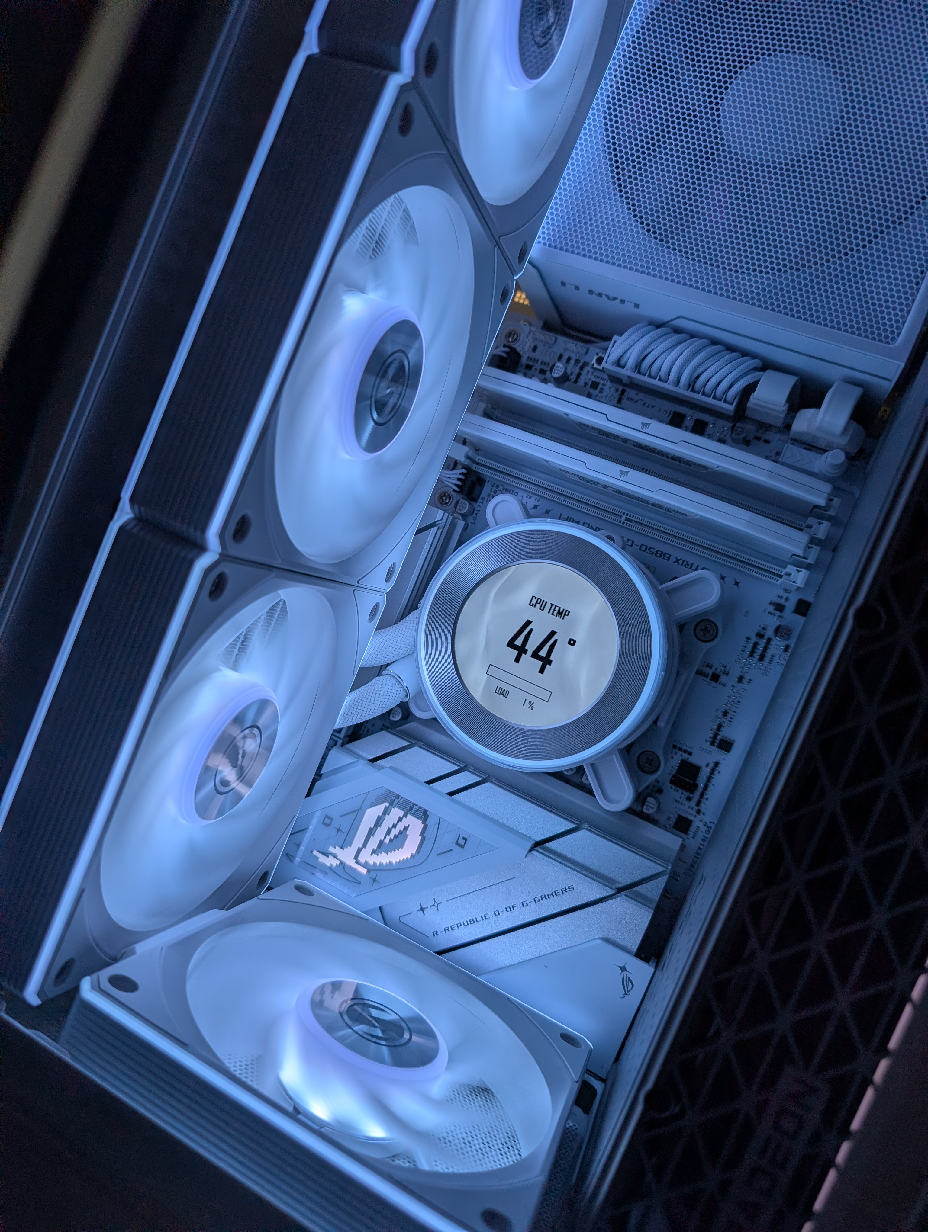

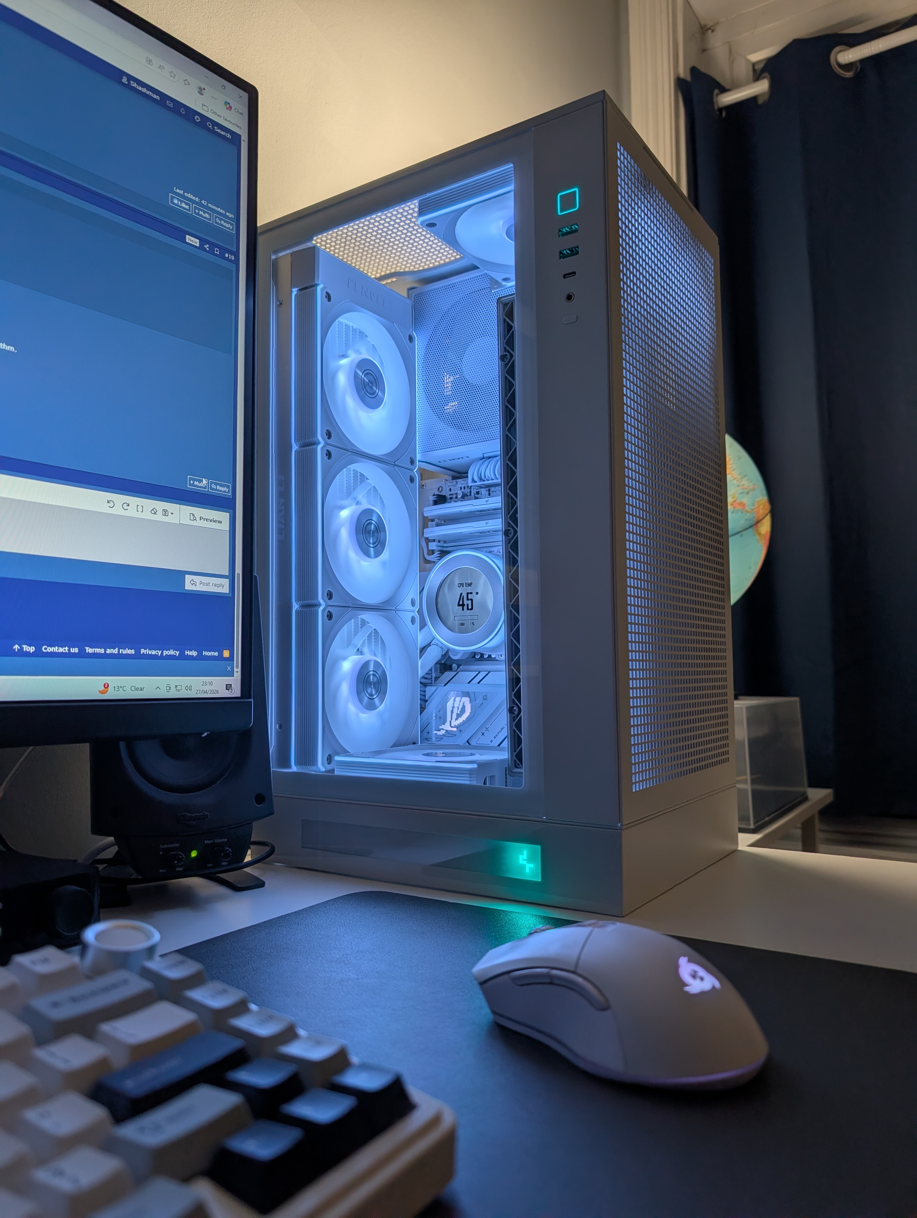

Finally put the build together this weekend.
Longest build ever. So fiddly. Had to shift the PSU umpteen times and the AiO is a very tight fit, even too tight as could only fit 1 of the 2 top exhaust fans I wanted.
Happy with the end result, apart from a noisy Lian Li 360 Hydroshift AiO which will need to be replaced due to a noisy pump. Also the digital display isn't working. I'm thinking it needs Deepcool software? It's plugged into a rear USB port.
Very nice looking build. Guessing you didn't use an SFX PSU? Mine would have been much harder to build without one.
I can't help on the display, mine doesn't have it and was one of the reasons I ended up with the 260 as the widely available 270 at the time had it.
Thanks! Got a few tips on how to try and solve the noisy AiO which I'll be trying tonight. If that works then I'll consider the build complete.
No, I used a Lian Li SX1000 which is actually quite small. Compared to the Corsair RM850X it replaced anyway.
