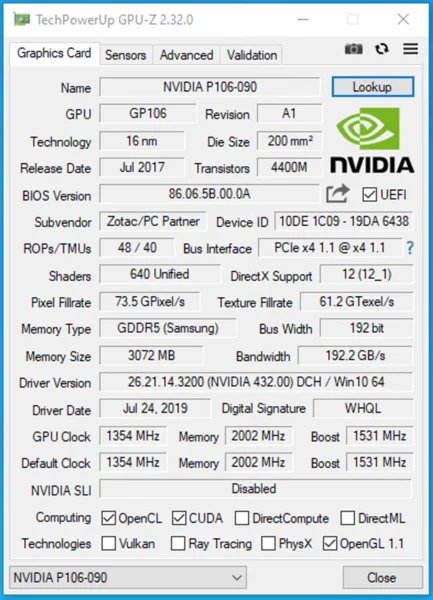

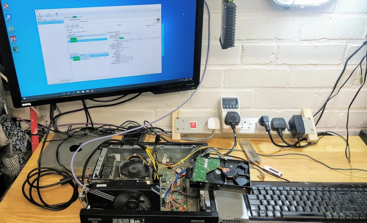

Quick update, the card arrived (surprisingly quickly for China!) and then ended up lightly 'modifying' an old test machine I had lying around (didn't really fancy putting an unknown graphics card into a machine worth more than 45 pence haha). After some faffing with drivers and a quite a bit of head scratching seems we are Folding! So far early indications seem to suggest around the 250k PPD mark which is pretty reasonable. It seems to only connect at PCIe 4x which I think is the card and not this machine (that said I've never stuck anything in the PCIe slot of these old 3020s).
Going to let it run for a day or so then will try a few of the different adaptors down to 4x and 1x to see if it affects performance at all. If not I may get a few more of these as they are stupidly cheap for their Folding performance it seems!

No this is a 3GB card (the GPUZ screenshot further up has all the exact details). I think that is why the cost of these sorts of cards has fallen through the floor, they aren't useful for mining anymore but for folding/boinc they seem pretty good! It's been running for a few days Folding now and seems to be settled around the 330k PPD for around 60-70watts of power.
