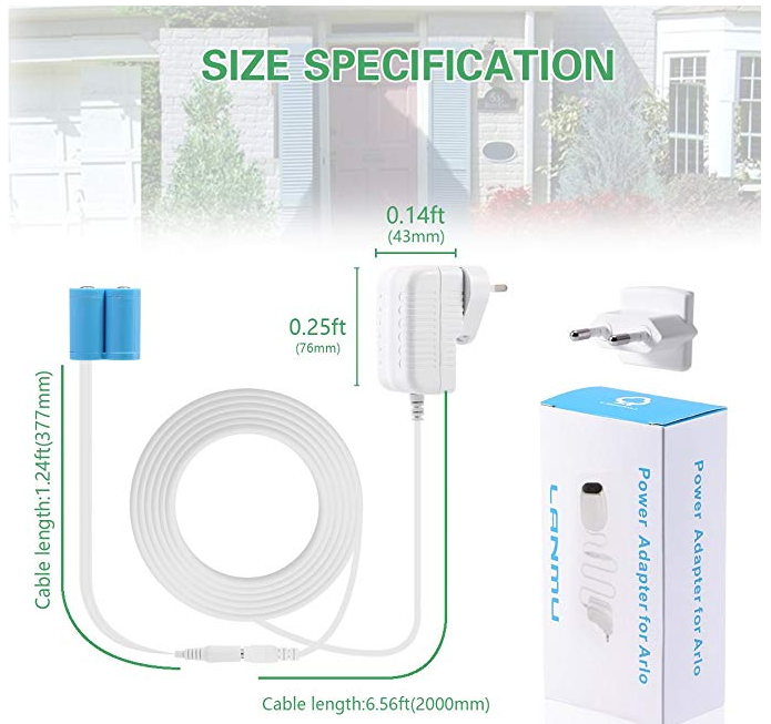

I've been looking at either the Netgear Arlo (ordered this but having second thoughts)
Power Lead for the Arlo
https://www.amazon.co.uk/dp/B06XYM7...t=&hvlocphy=9046518&hvtargid=pla-347803283456

Also i absolutely love that this product advertises the size of the wall wart thing as 0.14ft
The power lead for the Arlo one states it must be used with the AC adapter (last pic in the series). Even if an outdoor USB socket existed using the adapter would not leave much/any room.
It seems to me the solution is to drill a slightly larger hole to accommodate the plug and plug it in inside.
