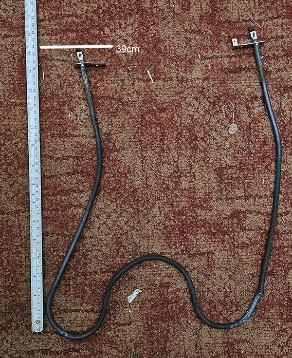

Oven was taking ages to cook so I bought a new one. Now taking apart the old one found the heating element fell apart.
Pics:
Do I just buy any old element off eBay and install it? Pretty much all of them look slightly different... some rolled into a coil, others are a "grill". Not gonna spend more than £10 beyond that price I might as well bin the whole oven.
Thanks.

It's £40 for the official one. That was my question can I use any element so long it's rated at same or more wattage? They are under £10 on eBay I can bend it to the right shape although it might be more length of element... then connect up the live and neutral and solder the earth.
This oven was real shabby the element wasn't even in it's enclosure properly, it will probably be better once I'm done with it. Then I sell it for cheap rather than scrapping it (bad for environment).

Don't get one that's a higher wattage. The oven doesn't regulate how much current is running through the element. It just turns it on and off. The ovens internal wiring might not be up to carrying the higher current.
Our cooker went through three Chinese Ebay copy elements in three years. I hipot tested a new Chinese Ebay one and it broke down at 400v. Bought a genuine OE one, hipot tested it over 1000v and it lasted nine years until 'er indoors got a new cooker.
Get a genuine one. And no you can't bend the wrong ones to fit, they are packed with silica sand and the sand will migrate when you bend them allowing the internal heating wire to move nearer the grounded outer tube. It will then short out, either immediately or much sooner than it should.
Make sure the schonky spade terminals make a tight connection on the element's spades or there will be localised heating / burning at those points.
I've replaced elements in numerous appliances over the years as an electrician and you need to make sure you get the correct one for the appliance.
