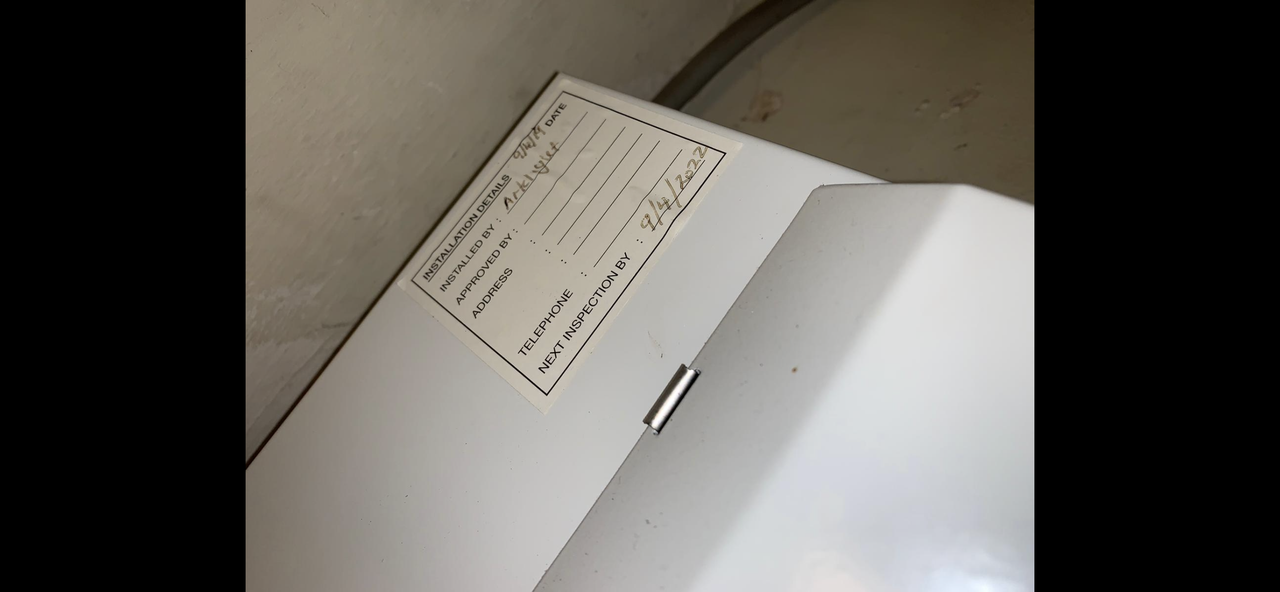

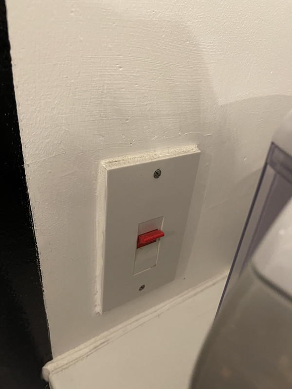

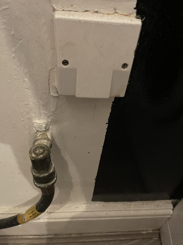

I want to replace the gas oven with an electrical standing unit. I have what looks to be an electrical box on the wall, assume this is for the electrical oven? Also can I just disconnect the gas myself, from the connector (see pics)
You can't just disconnect the cooker hose and leave it. If it's not going to be used it needs the bayonet fitting removed and capping off.

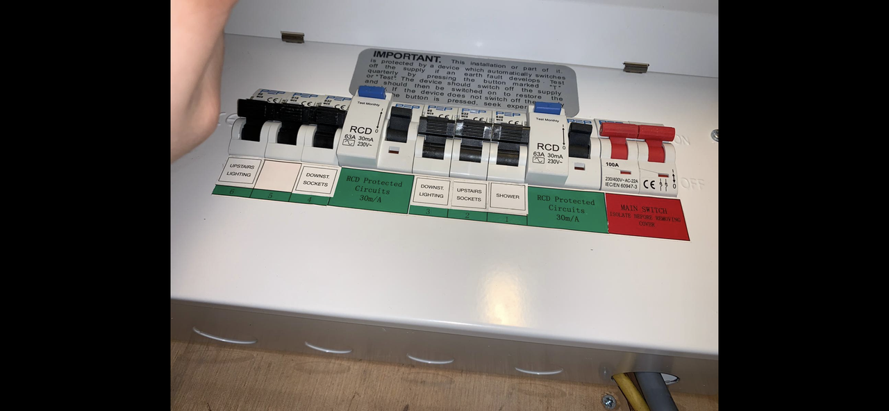

Check if there is a dedicated breaker for the oven, if it says 32A on that breaker then the chances are it’s ok and you should be fine just to pay the retailer their basic fee to install it. If there isn’t a dedicated breaker or it’s not rated to 32A then additional work is needed which will cost more than their normal fee.
That said just because it says 32A it doesn’t mean the actual I installation is up to spec but if it was done correctly the chances are it is. The installer will check all of that properly when they come to do it.
There’s a gas oven connected now, fully gas and it simply plugs into a standard 13 amp wall socket in the wall for the ignition etc. There is that box on the wall, next to the gas main, which links to the switch up above the unit. It doesn’t have anything rated on it. When I check the fuse box I don’t see anything labelled “cooker” etc which worries me. If it’s going to be the cost of running a new wire from the RCD through the walls / under the floor to the oven, it’s not worth the cost / effort. Is there any easy way to see what the switch for the oven is rated at? It’s just a white front, I expected to see something on the RCD box.

As you said, it can be plugged straight into the plug socket so no electrician needed but I would get someone in to check the gas as normally they are a bayonet connection (mine was) but depending how old the connection has been together the parts might not seal correctly when separated meaning leaks so best to get checked properly to be sure.

And yes, you'd need that gas pipe capping otherwise it will **** gas everywhere. Unless you can find somewhere further towards the meter to turn off the supply. Either way, you should get it checked out with a registered corgi fitter unless you fancy blowing up your house and the insurance not paying out. Or worse.
Box looks new and fittings old, suspect the cooker socket isn't live
Those gas fittings are designed to be user serviceable, its the point. they are self sealing, again thats the point.
