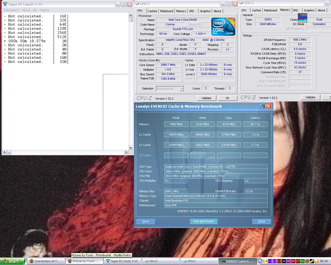

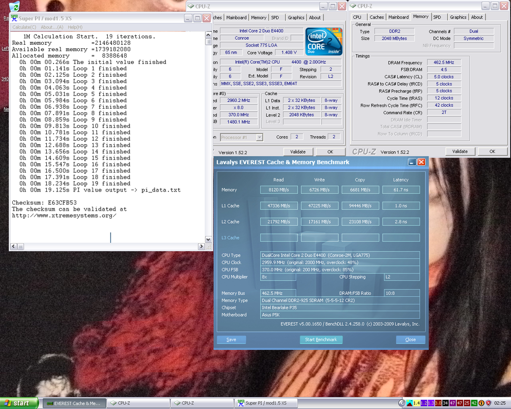

Here are some screens of a few results
370x8
340x9
Old Setup
370x8
340x9
Old Setup
