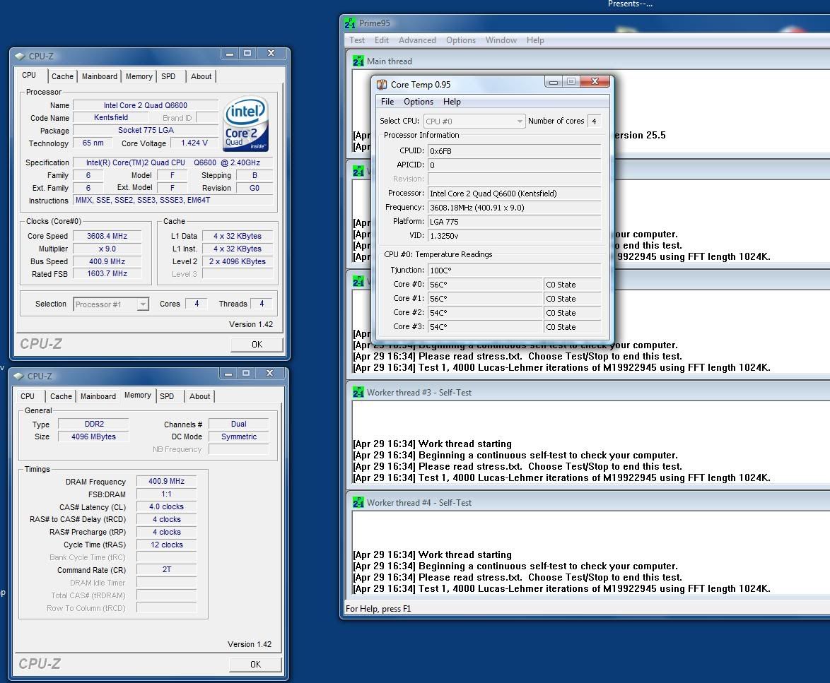

Same setup here but with 4gb ballistix 800mhz ram
Everything at stock apart from
Fsb - 400
Multi- x9
vcore - 1.45
Ram - 800
Gives me 3.6 no probs

Should all be in this screenie
Tried getting anywhere near The Bugs settings, but my system wont have a bit of it, wont even get as far as windows. My P5kC or RAM not up to it i suppose??
