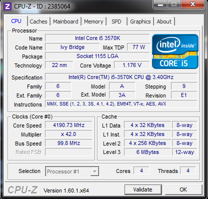

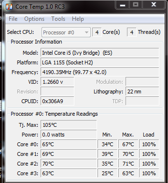

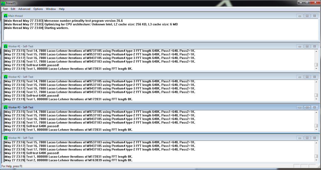

so I put multiplier to 42 and Voltage to 1.2, ran Prime95 for about 20 minutes temps didn't go over 71. However when I was running prime the voltage was only at 1.176 seems rather stable though.
Core Temp - http://i1216.photobucket.com/albums/dd365/jsastra/Coretemp.png
Prime95 - http://i1216.photobucket.com/albums/dd365/jsastra/Prime95.png
CPU-Z - http://i1216.photobucket.com/albums/dd365/jsastra/CPU-Z.png
Change LLC to 50% or 75% to get a constant 1.2v on load. Then try 43/44 multi to see if they're both stable. For 45 multi which may be possible at 1.2v (was stable for me at 1.22 but I didn't try at 1.20). With a 45 multi or more you'll need to Enable internal PLL overvoltage to get it stable most likely.
When you reach the point of instability turn off all powerr saving stuff (EPU/c-states) except C1E and speedstep and see if that stabilizes it. There's other things you can do but all of that will get 44/45 easy I imagine but if you want higher you'll need to up the voltage which causes more heat. All depends what temps you're happy with as you'll hit temp limits long before too much voltage becomes an issue.
One last thing, I personally found that BF3 on max settings 64 player was the best stability test I could do and a 1 hour prime stable OC would bsod in BF3 within a 1000 ticket round if it was unstable. Same for memory as well actually that passed memtest86+ and superpi 32m would bsod in BF3 lol
