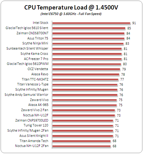

I was wondering what was the best CPU Cooler to get, I've heard good things about the Tuniq Tower, actually people don't stop raving on about them. However, when i've looked at pictures like these:
I've noticed the Asus Silent Knight II is better. However i've heard its louder, although thats open to personal opinion.

A lot of people with the Silent Knight on a quad-core haven't been particularly happy with it (the table above is for a dual-core CPU).
I would certainly consider the Tuniq over it.
for sensible temps @ 3.6 on air you will need a TRUE and a 2000+ RPM fan or duel 1600RPM+ fans... something like a Sharkoon Silent Eagle 2000
Look at the picture, look at the rankings. See that the Asus Silent knight II is lower than the Tuniq Tower. Although its at the same Degree's i'm assuming it doesn't have the decimal places.

I am pretty sure that it is just the way they did it. 0.X of a degree is a margin of error.
Anyway, as people have said, a TRUE and a Scythe S-Flex is the way to go.
If you start at the bottom of the chart you posted and work upwards you'll notice that all the coolers with the same temperature are posted in alphabetical order. So according to that chart the Tuniq Tower is just as good as the Silent Knight II :)
