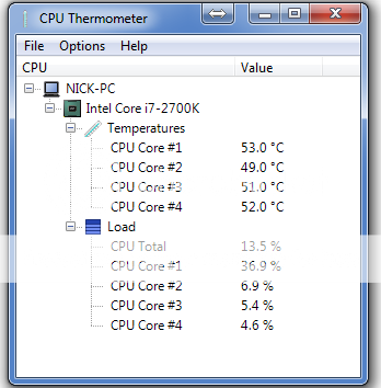

i have installed cpu temp monitoring and can just watch it creeping up and up to boiling point?

sitting around 55 degrees on each core and i will hoover out the rad and check the fan on it.. good point

55 degrees @ idle is that too high @ idle?
in watchdogs it goes to 100degrees and shuts down

i have stripped pc and given everything a good hoovering and now all cores sitting @ ~35 degrees so it will be even better when i redo the TIM
played watchdogs and sitting @ 55 degrees.

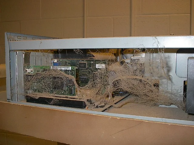

Damn you dust!!
Cheers Guys i think i know my direction now :)
LOL believe it or not it didnt look much but i pulled the rad off and gave it a good hoovering all thru the centre and round the edges.
aslo cleaned the fan blades which were dirty, my pc runs 24/7 so mucst make more of an effort to give it a clean out now n then.
it was more clogged thru the veins of the rad.
