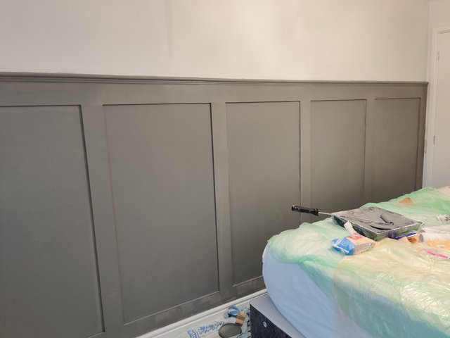

I've done some panelling 2 week ago in the bedroom.
Homebase do pre cut lengths I think 4ft long 4inch wide 9mm thick. All I needed was to make a few cuts with a hand saw, no nail glue and filler/sand paper.

Is the only photo I have
