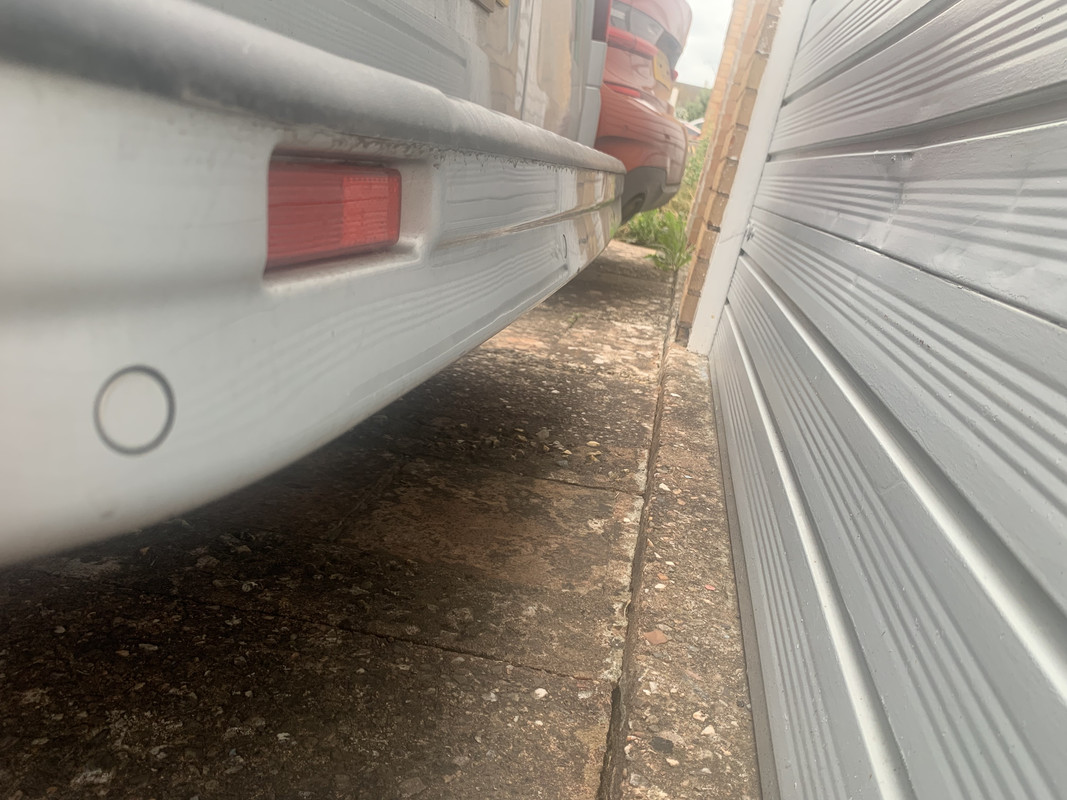

Hi all,
Looking to install a parking sensor kit (white) on to my Vivaro.
There's a few around but wanted some recommendations...there appear to be flat mount and angled mount options...
I'm also likely to change the radio to a double din with reversing camera at some point, is it worth just waiting?
Not sure how clear that is to you as I couldn’t be bothered to move the van but this is what they look like on mine.

easier if its the same as the picture.
Appreciate the response, I'll try get a picture tomorrow of the rear. Seems pretty involved and I've not done much with electrics on a vehicle before :/
