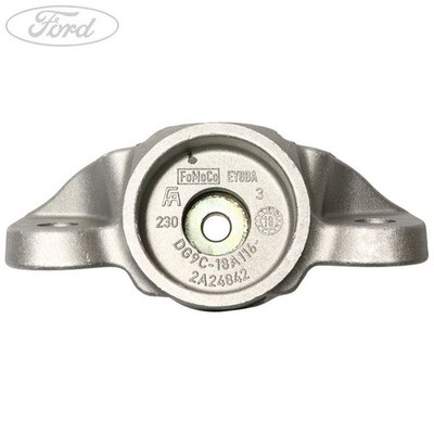

I think that's why I'm questioning this, vast difference in price.
What about for an extra £54?

In the end I just went with the dealer ones, didn't recognise any of the cheaper brands.
Probably get some sort of anti corrosion paint, to coat the top, hopefully this set will last longer then.
