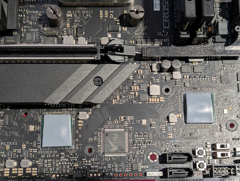

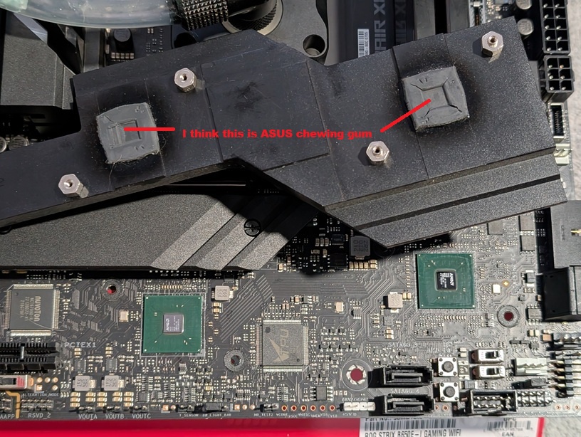

Im literally just about to do my Power Colour red devil 7800XT funny enough, but after a long day at work it probably wont be tonight, i'll leave it until tomorrow now, however, after using Gelid Ultimate Extreme thermal pads on my ASUS X670e Gene chipsets and reducing temps by 25c on one of them, I wasnt going to chance any other pads for the VRMs and Mem, so ive picked up 1mm and 1.5mm as no one seems to know what thickness they are, I also read some other reviews about people changing the paste on the GPU and using MX6, they said I was a bit too thick and wernt getting very good results with it, a couple of people used Gelid GC-4 instead and got much better results, so thats what ive gone for, like I said though, ive still yet to try it, im more interested in getting the Hot spot and memory temps down rather that the GPU die as thats not really getting above 65c under heavy load like furmark, hotspot is hitting 90 and at one point I got a reading of 80c on the GDDR.
Just to give an idea of stock pads over Gelid Ultimate Extreme pads, heres how it changed my chipsets temps on my motherboard.
Before:
After:
Before:
After:
Before:
After:
Before:
After:
