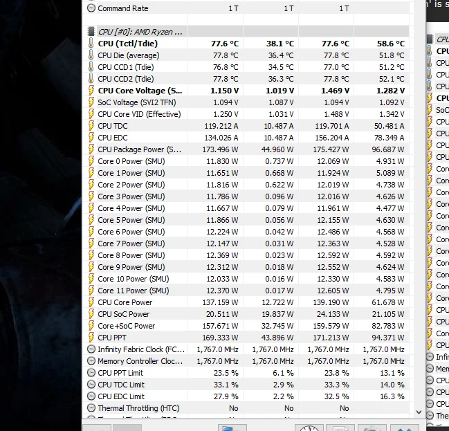

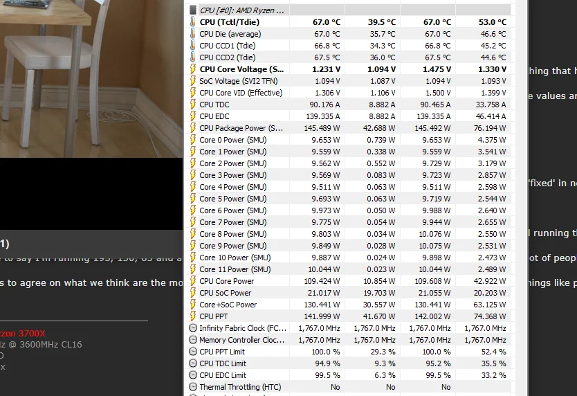

Using 'default' PBO Disabled this is the result ;
TDC 90 limit 95%
EDC 140 limit 99%
PBT 142 limit 100%

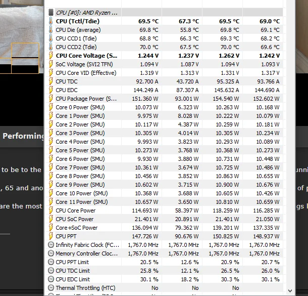

Using Buildzoid settings ( 333/230/230 x 2 )
TDC 95 limit 26%
EDC 145 limit 30%
PPT 150 limit 21%
Changing Buildzoid setting to 'motherboard' in BIOS ( which sets to the max the mobo will provide , i get the same.
The 'maximum' is set by your motherboards limits - which as far i can see cannot be bypassed.
EDIT ; CB20 wasn't pushing the cpu enough - Prime small FFTs gives it a good push.
TDC 120
EDC 156
PPT 171

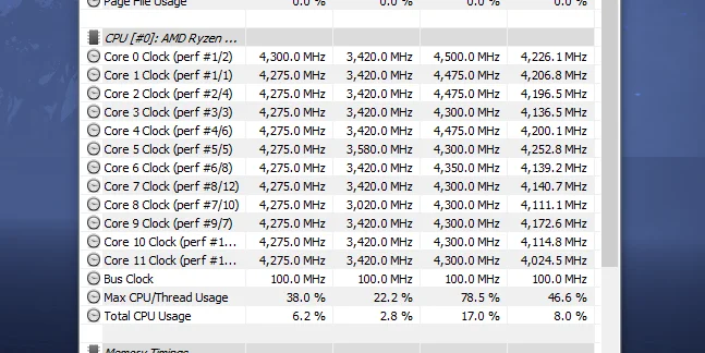

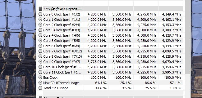

Screenshots show the clock speeds taken from a 2 minute run ingame ( same environment in game for both tests ) ;
Core Voltage - AUTO with XFR / PBO2 - DISABLED ( Average clock speed 4182MHz )
Core Voltage - AUTO with XFR AUTO / PBO2 ENABLED ( Average clock speed 4116MHz )
The minimum , maximum and average are all higher with XFR and PBO2 Disabled
