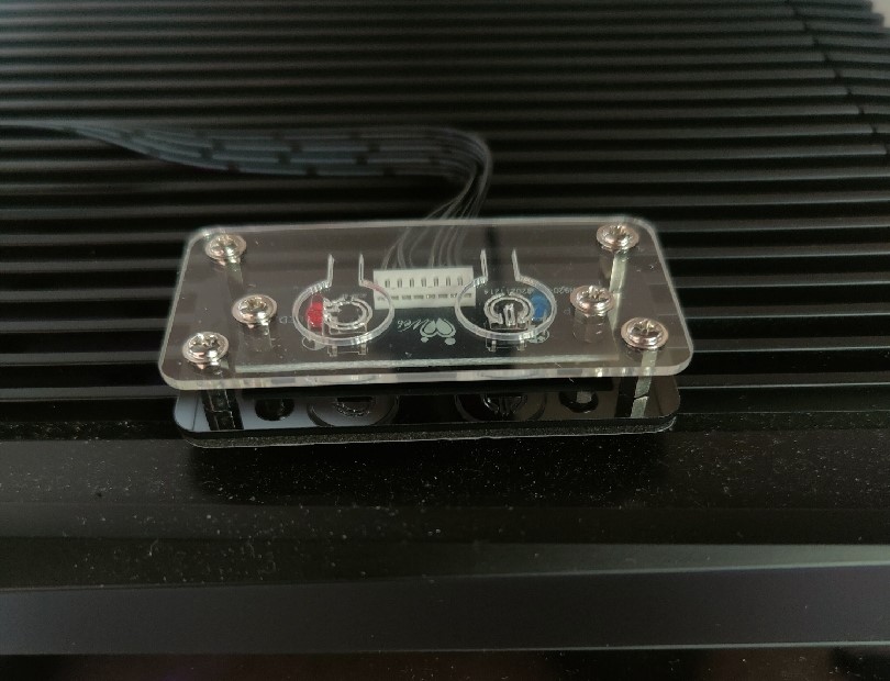

(have also had a new switch panel from LlianLi as I originally thought that was an issue)

but not the switch? (2nd switch essentially from LlianLi... and is only power switch connected to header - no others like LED, doesn't have a reset switch)

Also ordered another power switch / reset switch from the bay.
Have changed nothing else other than the switch and been working fine for 2 days.
So either there is something 'shorting' out when the 2nd LianLii switch is connected This was a replacement sent out (15 days!) ... or it just has not happened since and lucky.
Think ill return the PSU and see if this switch works ok.
Surely cant be 2 faulty Case switches !?
