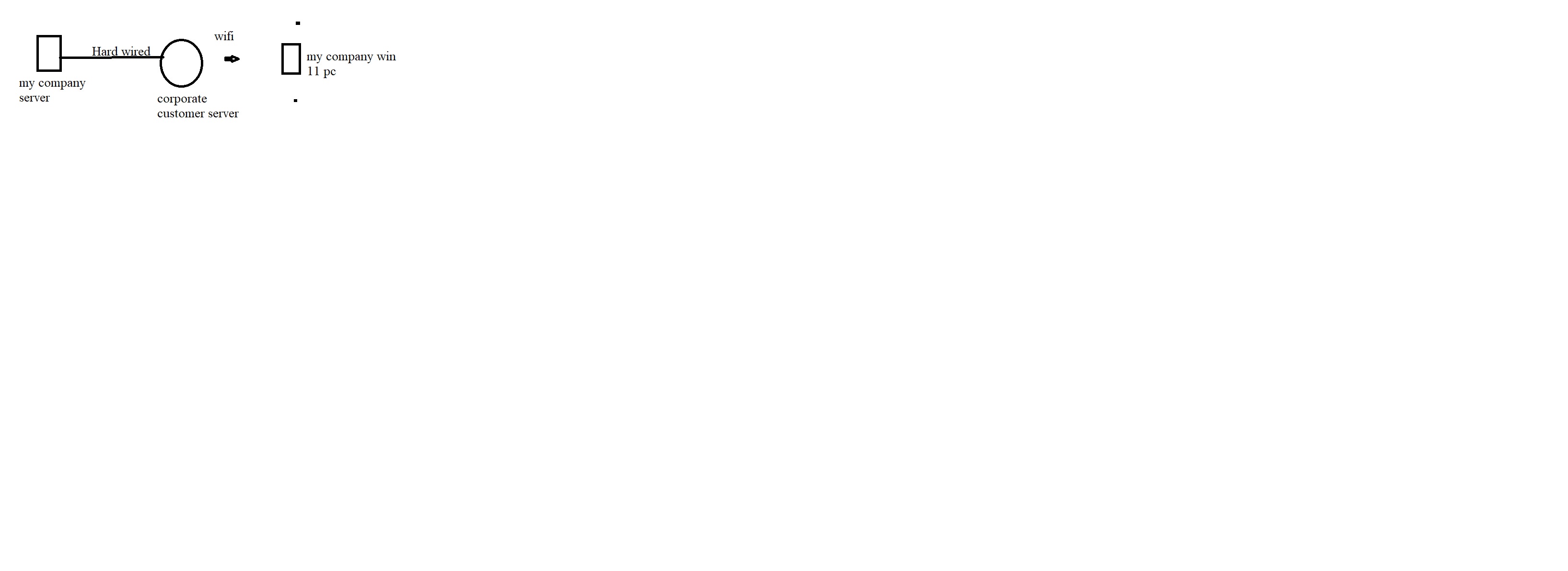

Describe your network layout. Do you have power line or mesh on your network?

Wish I could answer that. I'm not very knowledgable about this stuff. I suspect no powerlines but imagine that the corporate customer access points throughout the building are a called a "mesh"? It relies on thier access points to pick up its wifi. The customers I.T. chap has also had a quick look and assured me they are not blocking this pc and that the issue is this win 11 pc. Ended up pulling an ethernet cable through the building directly from my company server to the win 11 pc. and it works fine. But I'm trying to find out why the wifi is problematic for this particular device and for future reference and curiosity :)
