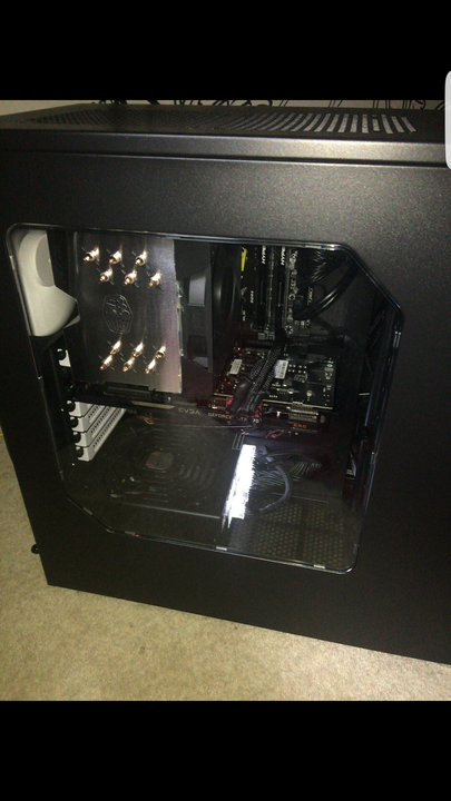

He has the monitor plugged into the GTX 970 via DVI, I've had him try HDMI, Still not sorted the problem out, I will post pictures shortly and get him to open up a support ticket.
Here's the pictures he sent me and his temps seem fine for idle.
Make sure all drivers are up to date
Check if the GPU is correctly slotted, including the PCI-E cables going into it
