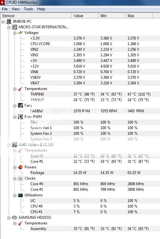

Just wondering if anyone can suggest any other ways I can pinpoint the cause of the crashing? I have ran HWMonitor to check temps etc. but I have no idea how accurate this is or whether they are within accepted limits? I have attached a screenshot

TWiNKLeT0Es - What should the readings be? I don't really know what to expect.
FixupSellon - Yup, Its either PSU, HDD or MOBO. Trying to determine which one as I don't want to replace them all. Plus the MOBO is pretty old so don't think I will be able to find a replacement anyway.
Gotcha. Looking at the BIOS it looks like both 5V and 12V values are well within +/- 5%
