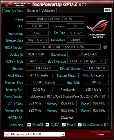

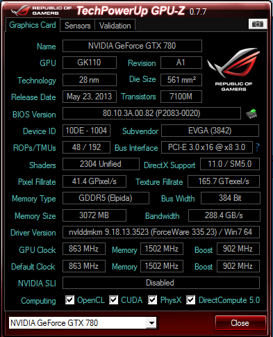

Can you download GPU_Z from techpowerup and post a picture of it?
here you go
