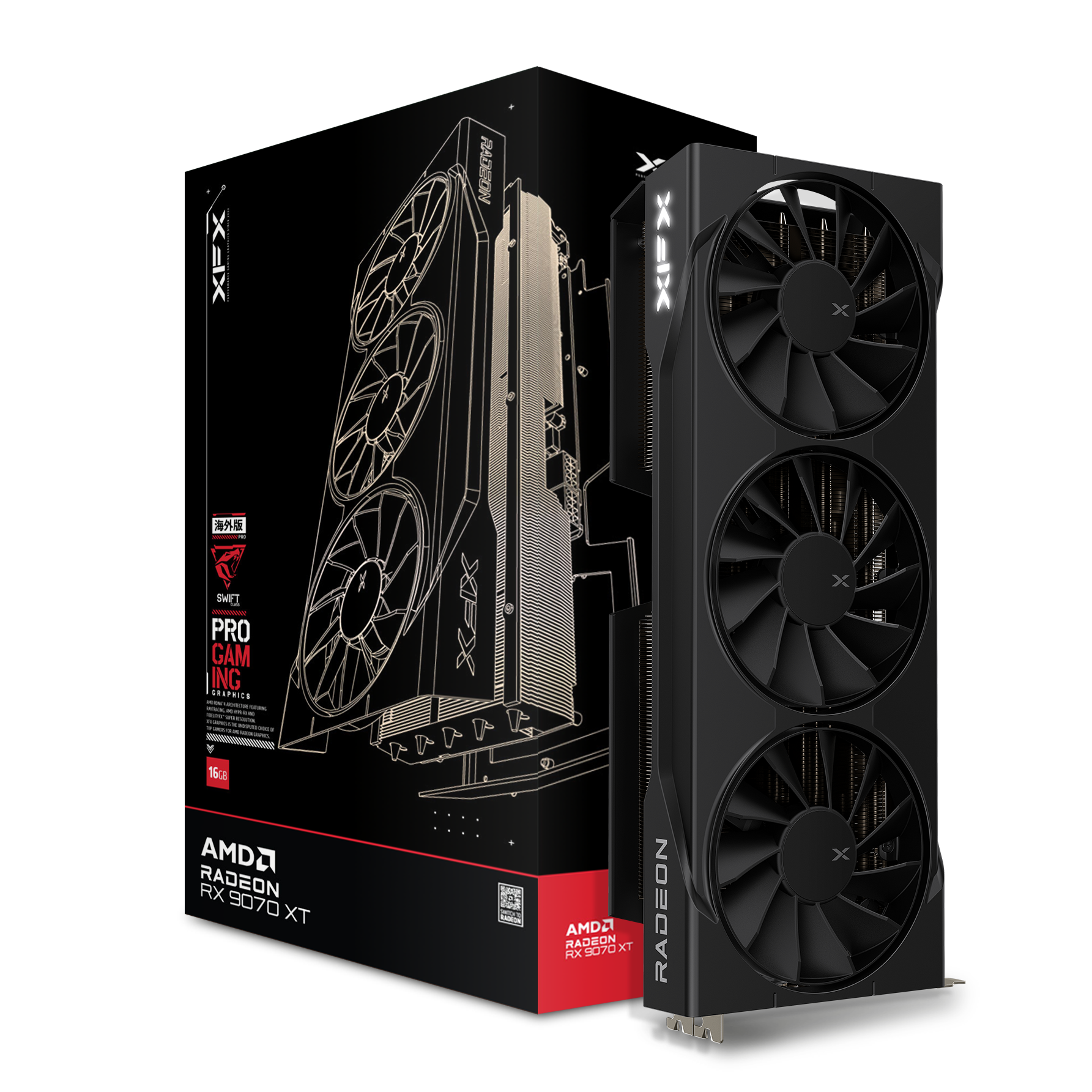

So after a few beers, I bought this:
OcUK Gaming B57 Bundle - Ryzen 7 5700X3D MSI B550M 32GB DDR4 £319.99
Phanteks AMP GH 850W 80PLUS Gold ATX Power Supply Modular - Black £104.99
XFX Quicksilver Radeon RX 9070 XT Gaming Edition 16GB GDDR6 PCI-Express Graphics Card £629.99
I think Ill put the 9070xt and phanteks PSU into my intel build and put the 6800xt and corsair RM750 into my lounge build?
