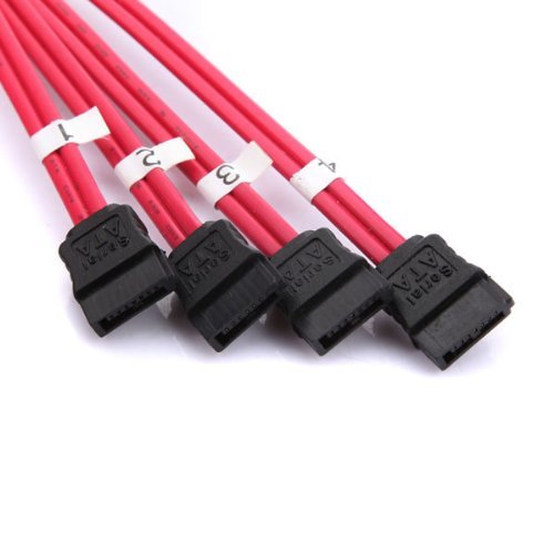

Isn't it just as easy to look at the cabling, I'm assuming your using a break out cable, and its plugged into port 1 instead of 0 which is why the disks at 4,5,6,7 instead of 0,1,2,3?
So failed disk 6 would be cable 3? Or am I missing the point?
