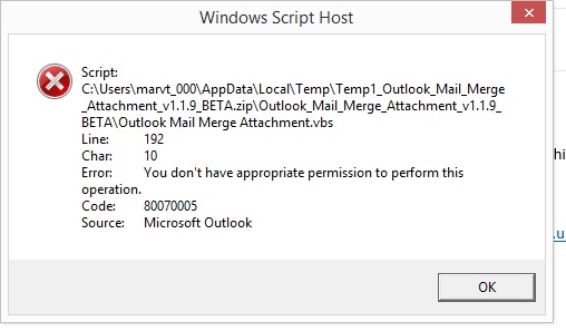

Only issue is that when i run the script and select my file i get the following error.
The weird issue is that it does actually attach the file to the first email in my outbox but then seems to fall over when moving onto the second. However if i run it a second time it will then add the file to the first and second emails (so the first has 2 copies of the attachment)

Yeah i had thought that. Winows does ask for permission to run, which i allow. It's only when it's trying to perform the actual script it fails. I think the issue maybe if Office 365 uses a different to previous version for moving between emails that is where it fails.

You need to open up the VBS file in something like Notepad and go to line 192 (where the error is occuring) to see what it's actually trying to do that it doesn't have permisisons for.
Got massively sidetracked with this. here is the text along with the line number. I don't know whether the text at the beginning counts as a line item though.
189 ' Add the attachment to each email
190 For Each Item In box.Items
191 For Each objFile in ObjWord.FileDialog(1).SelectedItems
192 Item.Attachments.Add(objFile)
193 Next
194 Item.Save
