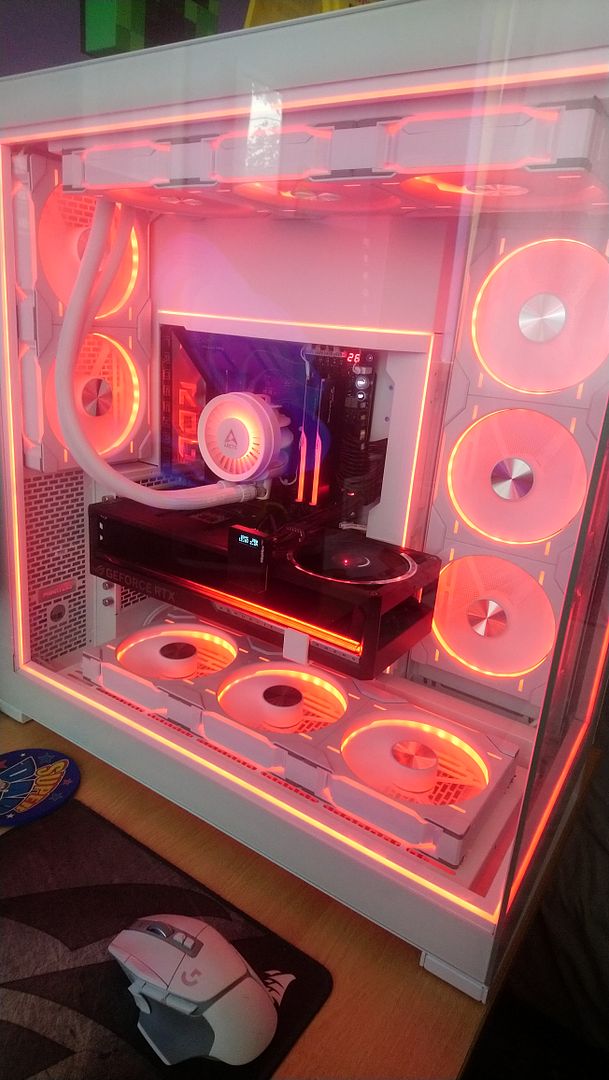

Phantek D30 Best way to wire them up in case
11 Jul 2003
8,122
Telford//west mids
2 x3 140mm 1 x4 120mm and 2 x 140mm
Case is phantek nv9, motherboard is asus hero x870e.
Wiring the fan headers will be installed on the motherboard it's the rgb that's going to be the headache, has anybody fitted these in a case with this many fans.
You can daisy chain the D30 fans, if you want to use the RGB header on your motherboard use the supplied adapter, I run 2 on mine that splits 11 fans across 2 headers, but with you having a Phanteks case you can use the built in case RGB that imo gives better options especially their cyan / purple mix.
@clone got the same case mate but I have mix of D30 140 x 6 M25v2 120mm x3 140 x 2 used th case rgb but I have connected an asus rgb splitter to the controller as well so that waterblocks and other rgb can be fed Glanza is right when he says cyan/purple it just looks so good
Love the D30s but god they are not cheap and those bloody connector clips had one that just kept popping off across the room ened up snapping which phantenks has kindly replaced as well as faulty M25v2 cable
All set up and running, tryed asus fan expert but was bugged so just used the stock fan configure in bios, I'm very happy withe the change of fans.
