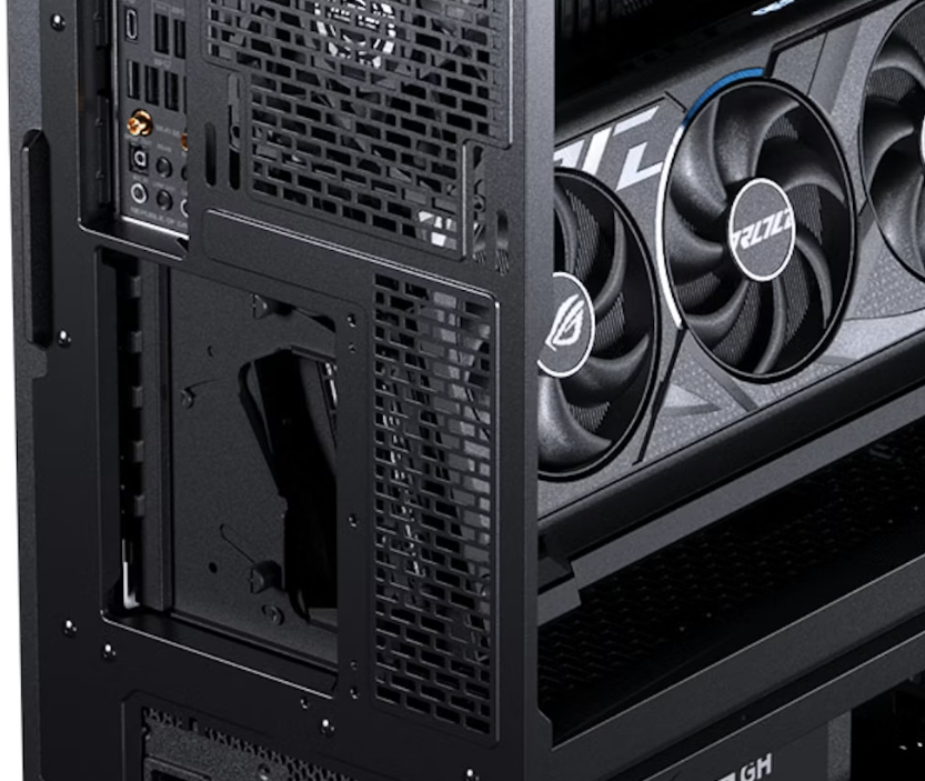

Phanteks PCIe Gen5 Vertical GPU Bracket
How it looks installed in a Phanteks case
