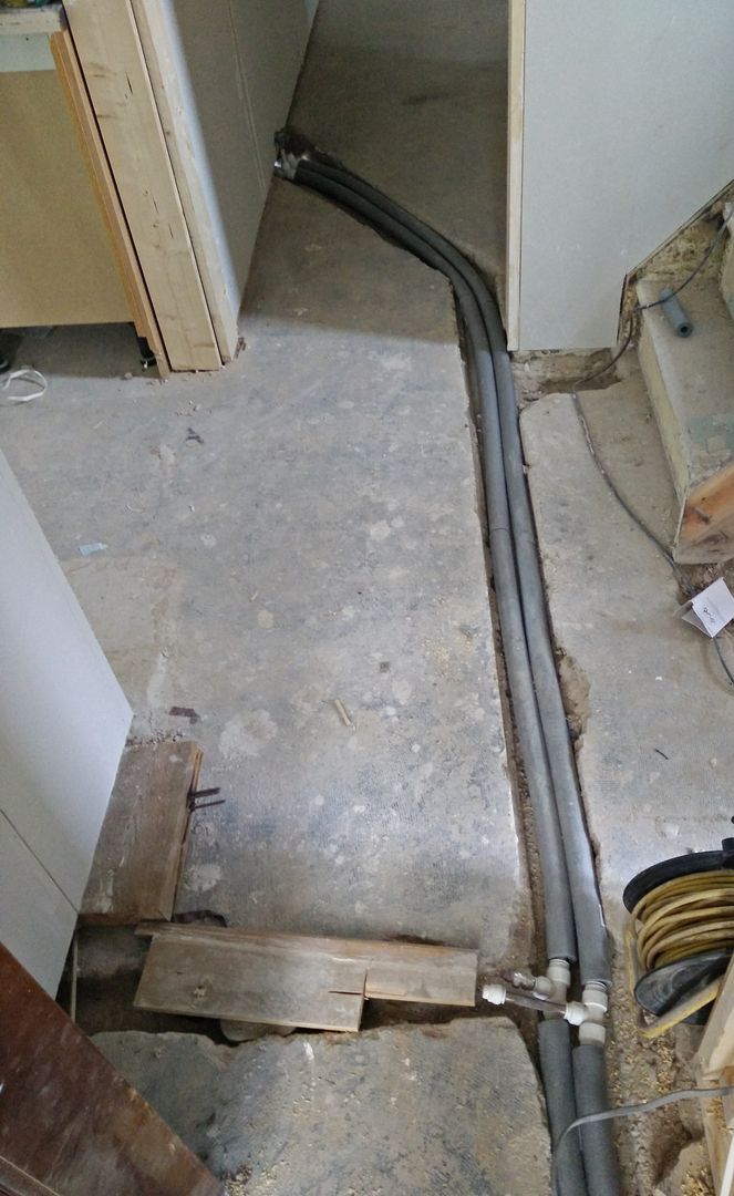

I've run all new CH pipework throughout the house, previously it was copper pipe laid down, lagged, then boxed in and then 2" of screed laid. Now I've pulled the copper out and the boxing in as I've had to squeeze Speedfit in. I've lagged it but now I need a solution on how to cover it. The best I can come up with is to lay sheet steel over the top thin enough so as not to be felt through the floor covering whilst hopefully not flexing under foot.
Other option I guess would be to concrete them in whilst trying to keep the fittings accessible.
What might you suggest?
