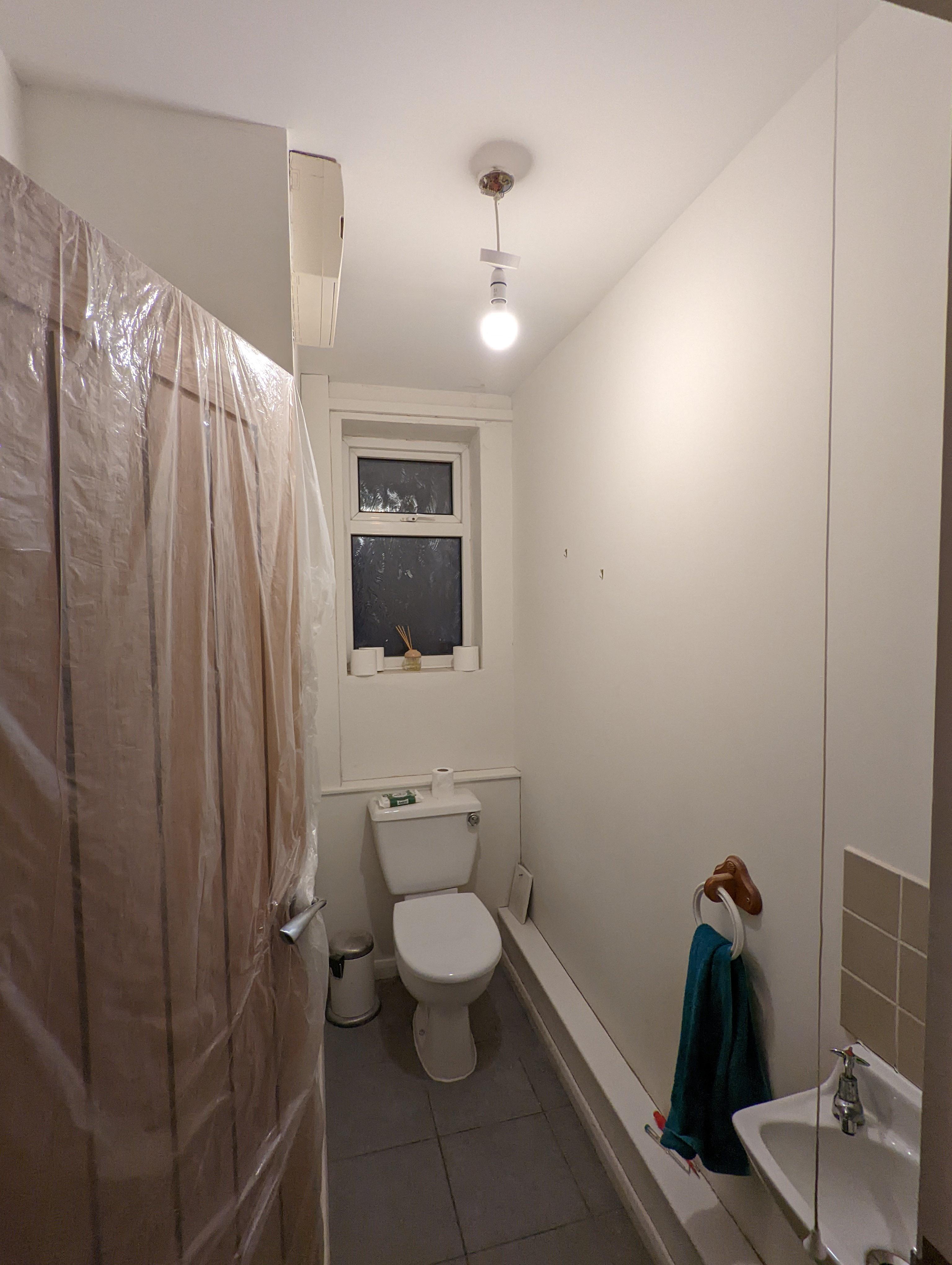

Has anyone got experience with PIR/microwave sensors for bathrooms (w/c) instead of pull cords?
What about wireless switches for the outside of the room?
I was going to change to a microwave switch so it automatically turns on (up to 12 mins apparently)
The current pull cord gets caught in the door. Ive recently had the door refitted and moved to its new opening position. I'm going to move the cable for the. Microwave to the "left" in the 2nd photo / above the sink so if i decide to change the microwave switch back to a pull cord in future then I have the option.
- are pullcords normally tied to ceiling joists? I realise that's why it's in its current position.
The reason it's not on outside switch is there's steelwork above the door wall and no available option for placement (I presume - blame the previous owner)
Is there an optimal placement /position for a PIR/microwave switch? I like the idea of having it out the way.
Note that above this room will be a tiled bathroom and shower tray so will be almost impossible for access.
- yes this bathroom is ugly and needs a coat of paint!
Currently thinking of going for this microwave switch - I've purposefully not gone for recessed options incase I find it a pain /wanna change back to pullcord.
Above this room is a shower /bathroom which puts me off having a "wireless switch receiver".
Note I know that I require a neutral and live/switched live for PIRs/microwave switches, as I have the boards up above I can take the neutral from the existing fitting.

Quinetic Wireless stuff is usually quite good and will give you a switch on the outside of the door if you want to try that option. However if you're going to the effort of relocating the switch you have a few more options available to you.
Assume it’s just the light switch and there’s no hidden shower in there?! Don’t think so as you said WC?
I’ve got PIRs in our toilet and bathroom. Works perfectly well - same size as an LED downlight and just as easy to fit. Just as easy to remove and fill over too if you don’t like it!!
Aye just the toilet in this one.
OK sounds good. The one I've bought is surface mounted rather than recessed, as I know you can filler what you holesaw but feel it'll never look quite righ after if I change my mind :cry:
