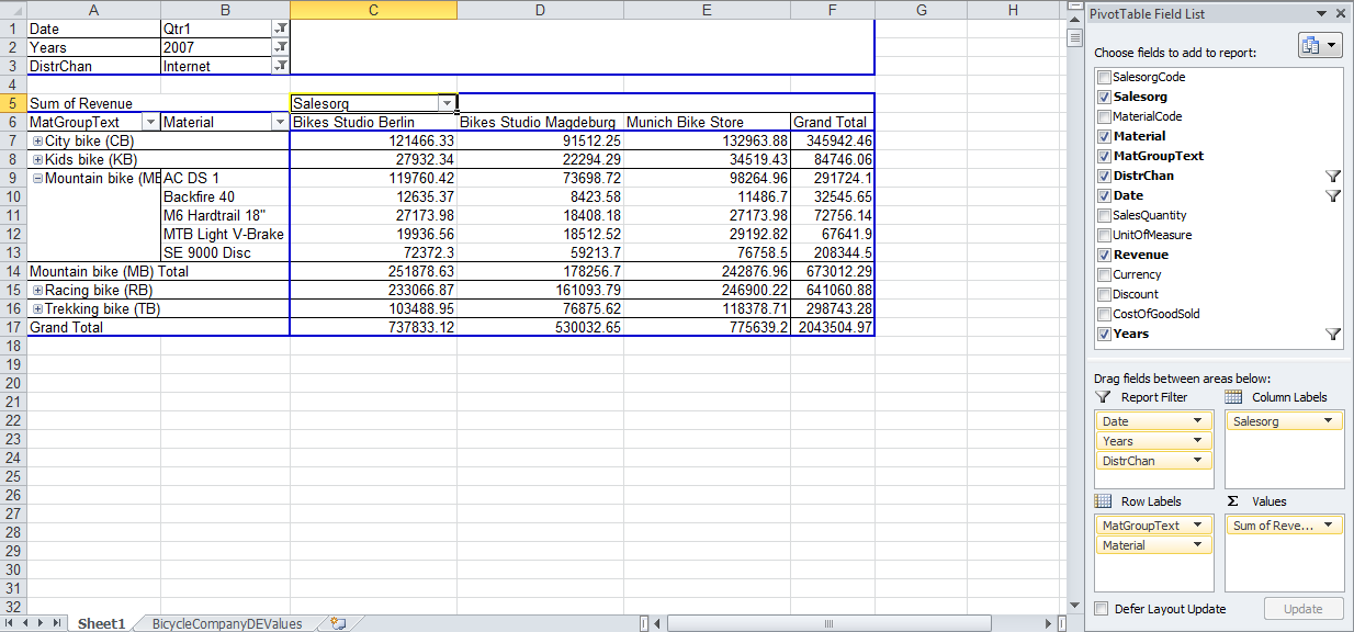

Got a more tricky issue which is bugging me a bit (lot)
I'm trying to:
This is what the model answer looks like...
But when I add the Material code + Material in, it has strange formatting. Not to mention I don't have a clue how to edit the headings to get the results asked for!
Any advice appreciated!

Right click on the Material Code and untick the subtotal option.
And you don't need to edit any headings, you need to add calculations for Net Sales and Contribution Margin to your data.
