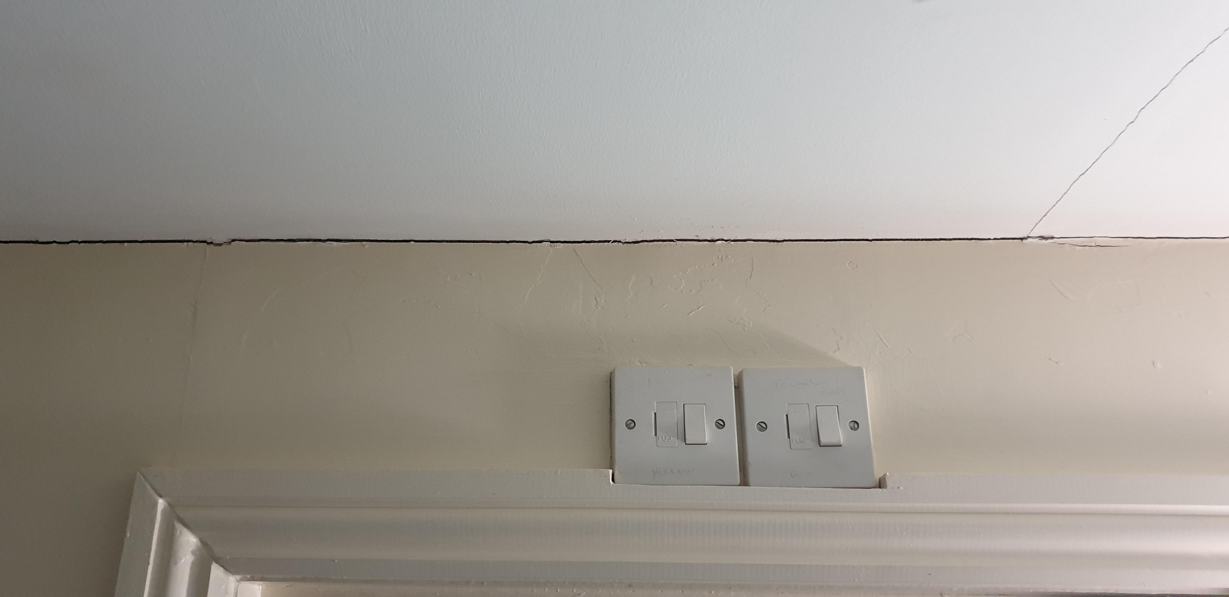

Gaps around the edges of rooms are the bane of my life. He is one example, a nice 2mm gap between a plasterboard wall and the ceiling that has opened over the last couple of years.

I've got it where the paper jointing tape in the corners and around the ceiling has blown away in places, I.e. detached from the skim holding it to the plasterboard as a result of being incorrectly fitted , but yours looks like it was never taped, or the walls are sinking away from the roof joists?
Yeah. Not really sure if it was taped. Struggling to see. In that section the ceiling feels solid, so agree it may be a downward shrink. House seems to have a lot of bits of ceiling that don't seem to have been taped.

Ouch that looks terrible, such a botch job, bad socket placement
Thats a lot of movement for plasterboard
Also some lolworthy plastering above the door there

Looking again it looks like it may have been taped. There seems to be little fingers of fabric at regular intervals. So guess the tape has popped. Ceiling seems firm, so guess it is downward movement.
The room does suffer from an mdf floor that is very creaky and soft in places.. so that that needs replacing. When the room is revamped.
Could the floor be causing the issue? Do stud walls sit on the floorboards?
