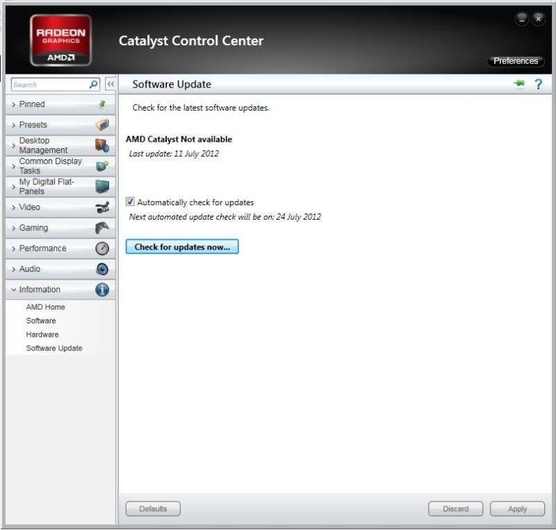

So tried a couple of other drivers by uninstalling and using drive sweeper but everytime i was geting the orange question mark at the end of the install pointing to maybe some errors occured!
Also i found after numerous driver installs that on the update page it doesn't list the version number anymore and even if you use an old driver and try auto update it says upto date:(

I connected to my other Samsung monitor which is a 60hz monitor so i plugged in the HDMI and it said something about would i like to config AMD audio something along them lines wish i had taken more notice, i had CCC open at the time and when i chose no or something along them lines, CCC displayed the driver number 12.3!

Spoke to soon thought i'd try a later driver and gain once installed i get that question mark warning, but does seem to be working fine in BF3, i wll go for a fresh install.

Have you tried not using ccc?
Funny thing but i had a 6850 and i used to get this install issue when installing new drivers. I would try re-installing the drivers (a pain in the arse i know) Then slect custom and just tick the drivers and any other importnant software. And totally forget about ccc. Iv never had this issue again may be worth a shot.
I currently run trixx with a 7850 for all my overclocking needs.
Edit= Sorry forgot to ask what does it say in the install log about the warnings when it errors? Just read again sorry it doesnt say!
