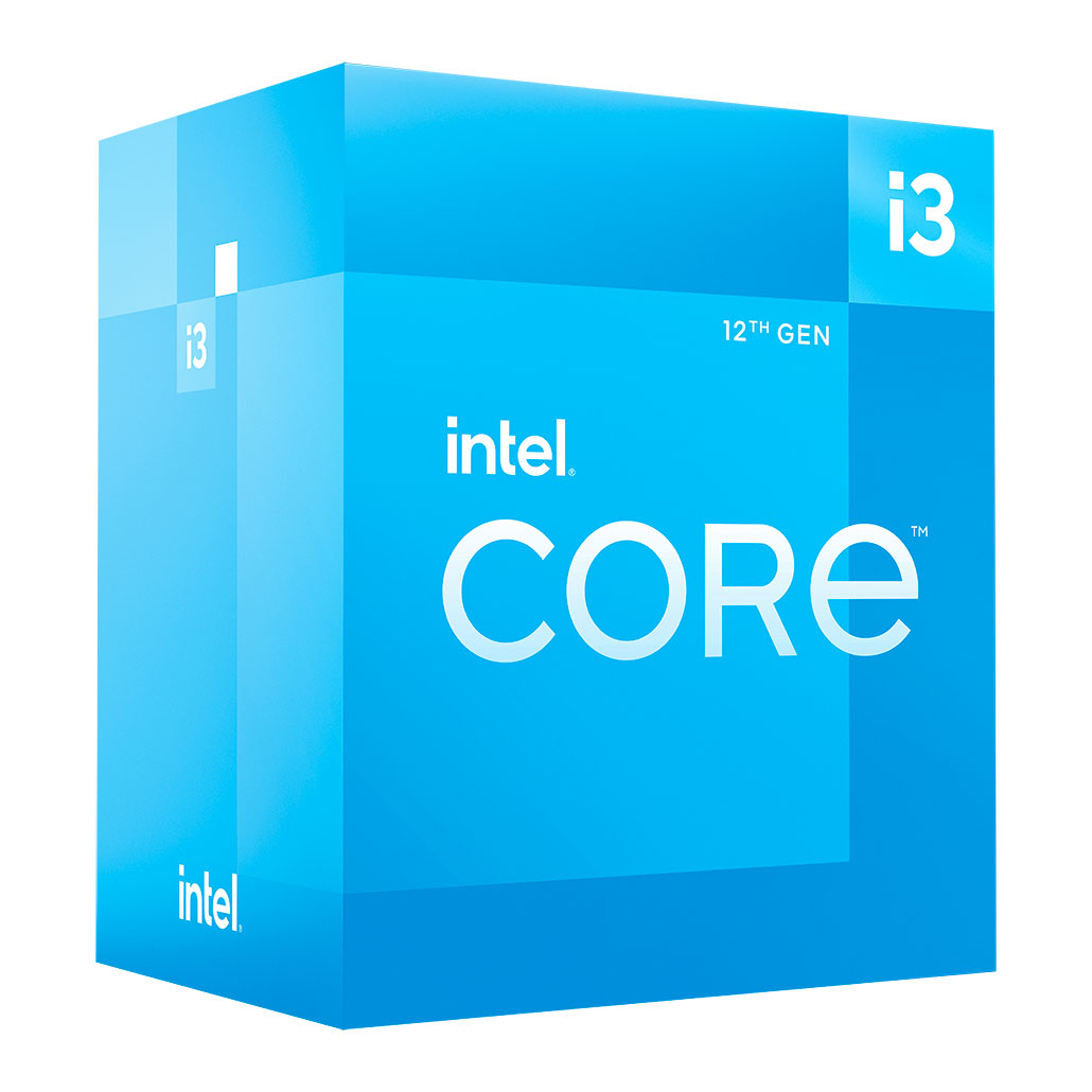

Motherboard has 4 M.2 and 8 SATA ports, I haven't checked manual or tech specs for exclusions on what can be used when/with what.
The 12100 has onboard graphics, but the i5-12500 does have a better GPU with two media engines (12100 only has one).
The PSU has a hybrid fan mode where you can turn it off at low load and it is bult by Seasonic, who usually build quiet PSUs (coil whine aside).
Case is large, but is bullt to be quiet and can be expanded to have more 2.5/3.5 storage.
ASRock are usually one of the better motherboard makers for idle power, but I haven't seen any testing and this is a high-end board, so it's unlikely to be that low. I'd say 30-40 watts is likely.
My basket at OcUK:
Total: £641.89 (includes delivery: £11.98)​

Ive ordered the Motherboard and the CPU. The Team Force RAM isn't on the QVL list, but that list does seem a bit outdated. Will these be fine/fast? :)

DDR4 is pretty mature at this point, so I wouldn't expect you to have any issues. Easy enough to get a similar priced alternative though, if you prefer one that is. For this usage, I'd personally rather have 3200 JEDEC memory, which I know is a bit slow, but it runs at a lower voltage and won't require any messing with XMP.
Is 32gb of RAM over kill for a media server?
Probably, but RAM is cheap for now, so for the small difference in build cost, I don't think I'd bother with 8GB sticks. They're quickly becoming obsolete (due to their low capacity), especially with the potential performance loss of high density (16Gbit) 8GB sticks.
