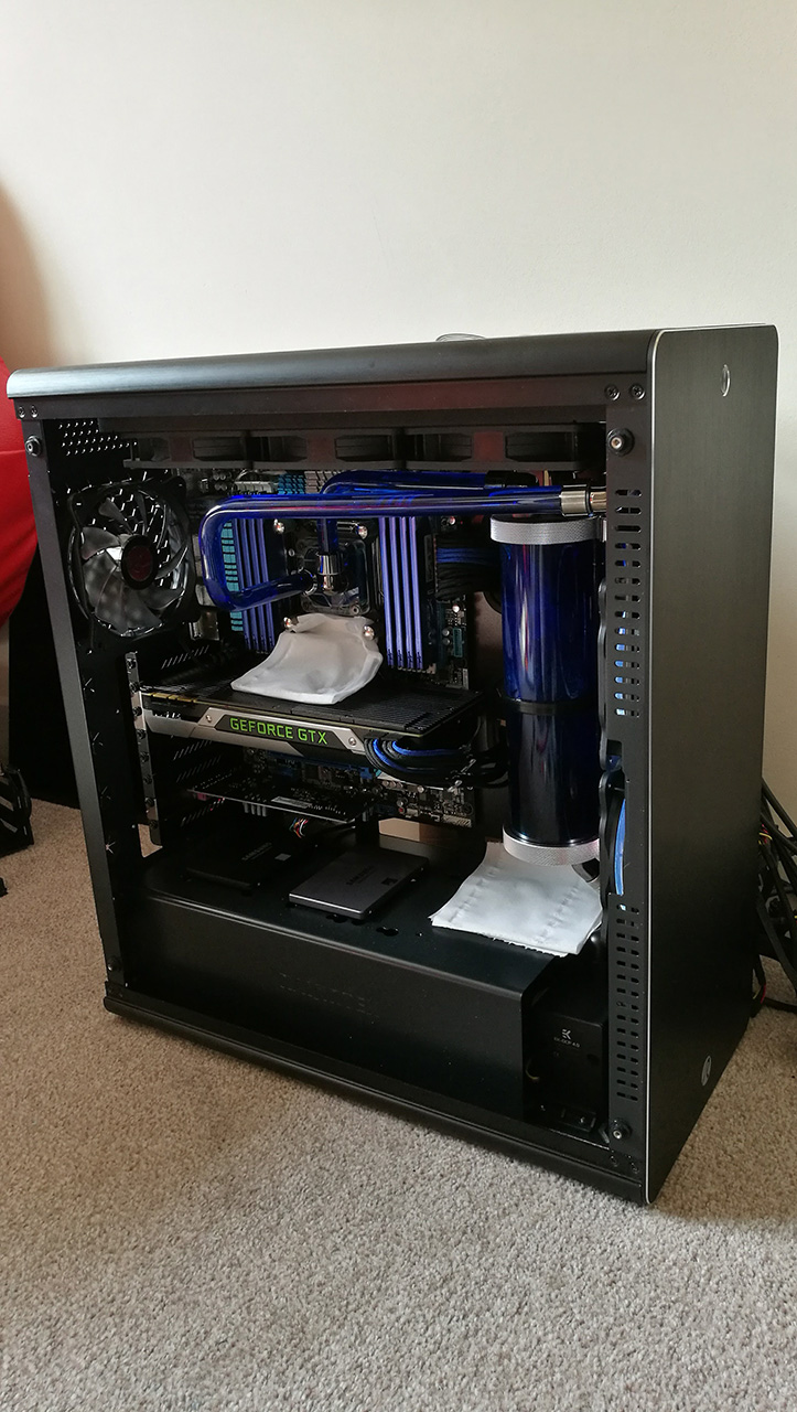

It's an NZXT H440, not the most "premium" of cases but I wanted something black and orange to fit the theme. It is pretty spacious though, I've got a 360 rad in both the front and the top as well as enough room for that reservoir that you can see in the 2nd pic.
It's actually more spacious than my Raijntek Asterion Classic (that's far more premium), which was the case in my 2nd hardline build (CPU only), only had room for a single 360 in this (and the front has no airflow, so pointless having a front-mount anyway:
