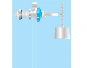

First pick is the ballvalve, inside that housing is the washer mentioned earlier.
Should be really easy for you as you have plenty of room there too work. Oh and the ballvalve does not have to be brass and also can be different to the one in the picture asking for a torbeck side entery is probably your best option.
will look like this
