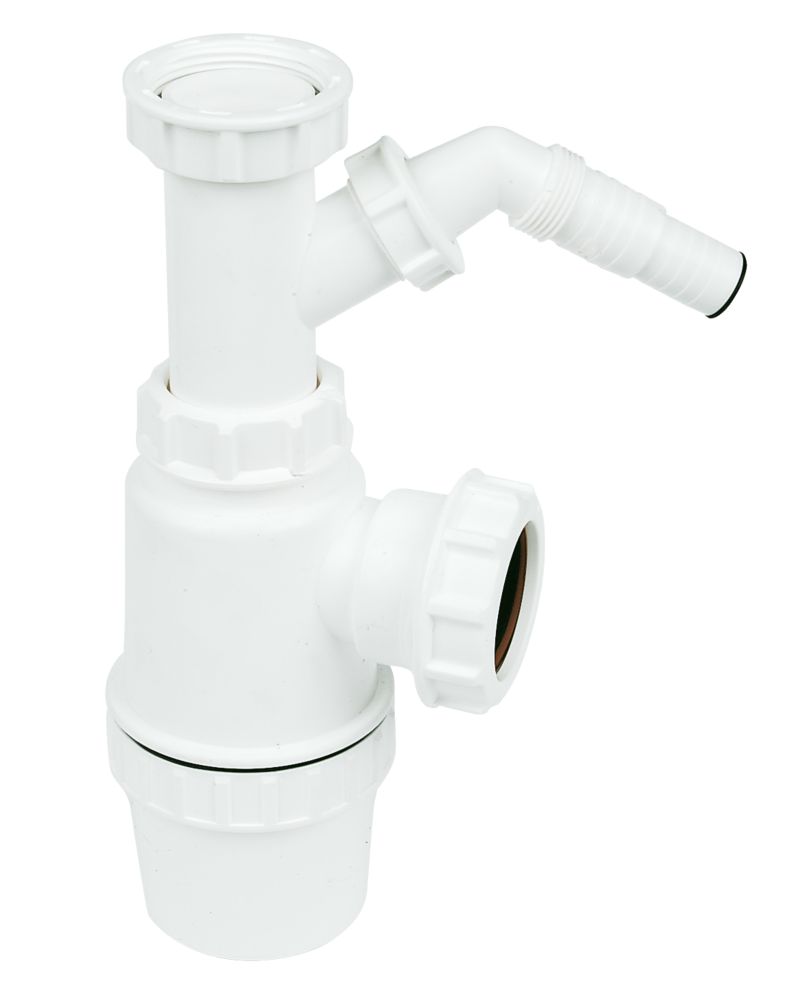

Anyway - I'm simply wanting to add a new trap to a sink in my utility room to add an extra outlet for waste.
So I bought the relevant trap from screwfix and it appears my sink has a 38mm male screw fitting and the trap is a 40mm trap............
So is there a simple coupler I can get that will have a 38mm female thread on one side and a 40mm male thread on the other?
Plumbing expertise most welcome!

Yes, I've seen things like this which would be perfect:
But I then need to add the drain outlet, ie like this one:

Are you sure you don't just need a european to uk waste fitting adaptor eg like below?
1.5 inches is 38mm vs you want 40mm
I had the exact same issue previously and this sorted it. Happens with a lot of European sinks and ikea sinks.
Its gone up 20 pence since I had the issue 2 years ago. U want 1.5"

Ah brilliant, you're spot on - this did the job, in cryptographic terms I did a brute force approach and bought a bundle of options, this was perfect...!
