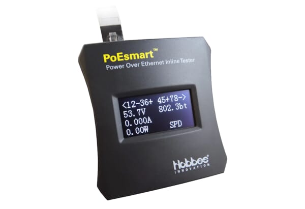

Any of you know about a POE inline tester. We are currently using this one at work
But we will need one that's calibratable, i'm amazed Fluke don't seem to make one.

Because it's for work, need evidence of accuracy.
I specifically asked about an inline tester not just a standard tester. We need to accurately measure a devices power consumption.
This is our first POE powered device. Previous IP devices have still been powered by 28V so super easy to measure power consumption with a multi meter
The switch will tell you the power consumption, otherwise you're splitting open a length of cable and hooking up probes to the power wires and putting a current coil around the positive wires.
If this is for certification purposes then look at / talk to https://sifos.com/ethernet-powered-device-testing/#PDA
Looks like we'll be going with one of their devices, so thanks for the suggestion.
