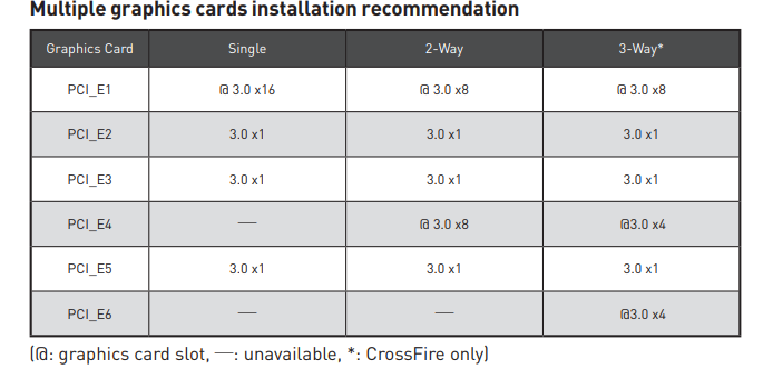

Z390 only has 16 lanes for pcie devices so most likely the pcie drive is taking lanes away.
will it hinder performance. Most likely as the 3090 is a pcie 4.0 gen card. I don’t think there is much difference between 3.0 16x and 4.0 16x but 3.0 8x vs 16x could be a different story as it is a powerful card.
You’d be better off with a decent m.2 nvme.
As per the rest of your motherboard manual:
With a 2nd PCI-E Card installd your GPU will only ever run at PCI-E 3.0 8x (~8GB/s) so your 6.4GB/s is reasonable after overheads

The slot was indeed running at 8x and in fact I found there is a board inspector feature in the bios that lets you see what is plugged in and what it’s running at.
So, I decided to take out the optane drive and install Windows on an M.2 that was previously an empty scratch drive.
Running the benchmarks again, the GPU bandwidth bench did indeed (roughly) double.
