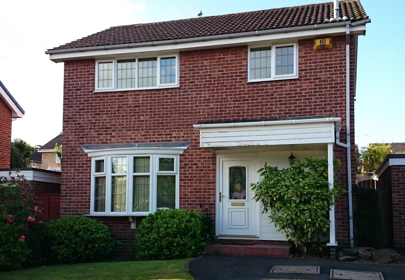

We had a porch built about 7 years ago, to replace a flat roof canopy that soaked up the rain and dribbled it back out for the next few days. I couldnt see the point in repairing it, so went full on porch. We had a few quotes, and I specified that I wanted it to match the house in brick and style, the side window had to match the bay window and be the same height, the tiled roof had to match and also T&G flooring with Amtico to match the current hallway flooring, and including outside lighting etc.. We also got them to replace the guttering front and back, and I maxed out the size without needing planning permission :D.
According to the builder, we should also have an internal door, but I said NO, and signed a disclaimer to say it was my choice to not have it, as I didnt want it to be enclosed.

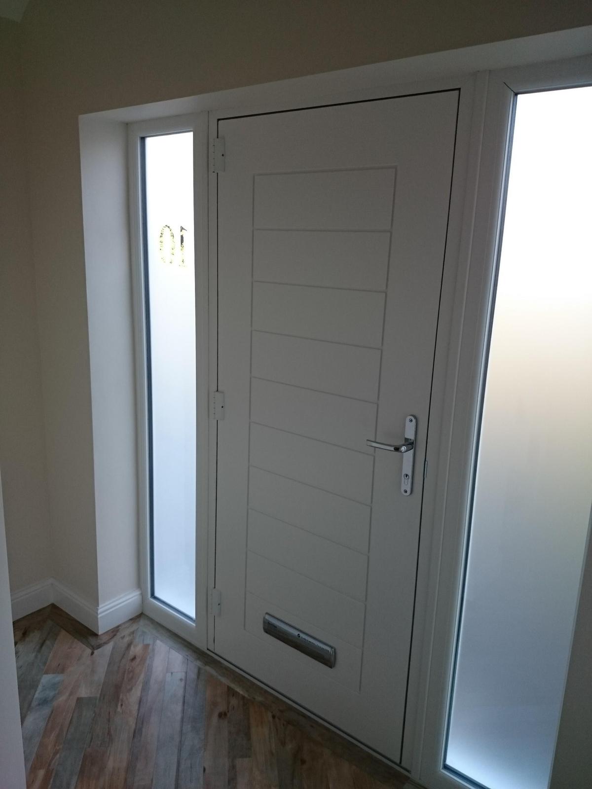

The front door is a Solidor, with frosted side panels with the house number etched into the glass, it alone cost 1.5K. They have a great website to build your own door inside and out, and I then passed the details to the builder to sort out.

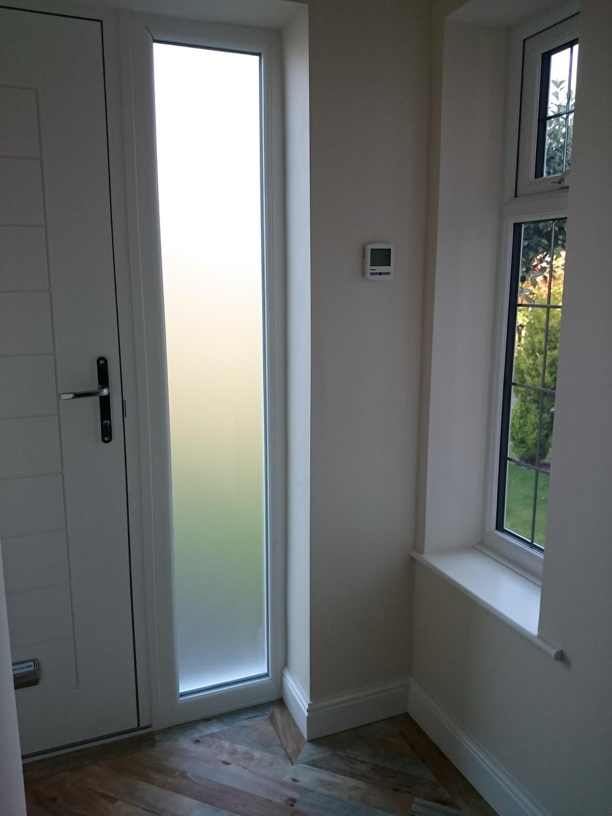

The internal ceiling is vaulted to give a more spacious feeling, with a pair of LED lights pointing down.
We love the thing, and the builder did a great job, as I told him exactly how I wanted it, so there was no misunderstandings. And it lets way more light into the hallway than before.
The total cost was 7.5K, and we were told its more expensive than you first think as its like building a mini extension, with proper foundations, insulation, drainage for the guttering, electrics etc..
One chap quoted us 12K!!
Here's a few pictures to give you an idea, not sure what it would cost today tho. Any Q's just ask :)
Beforehand, 7yrs ago:
Now:
Inside:
